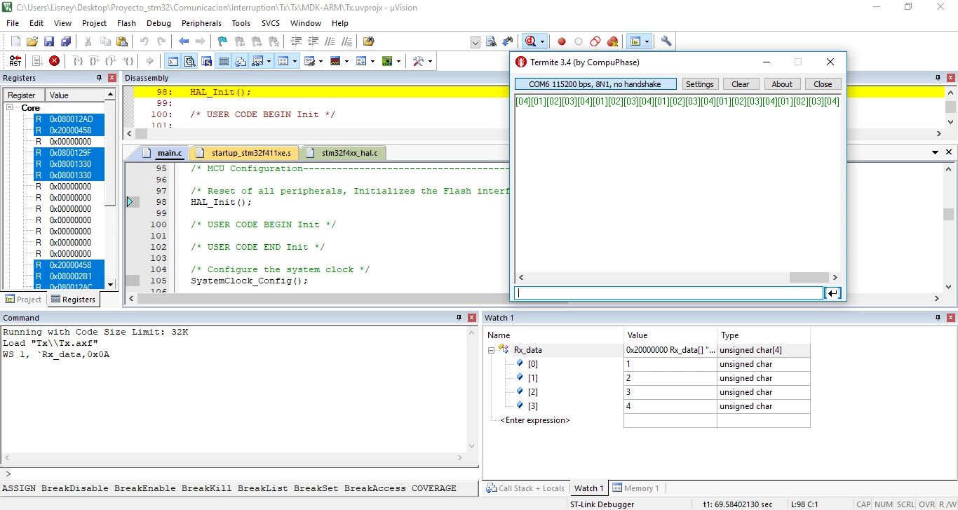

I agree I am working with interruptions as you suggested to me using the code:

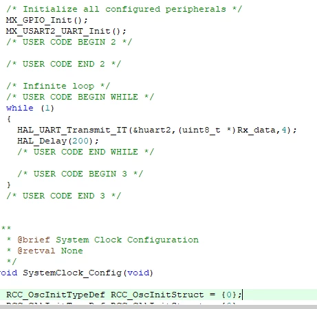

Transmitter code.
uint8_t Rx_data[]={1,2,3,4};
 while (1)
HAL_UART_Transmit_IT(&huart2,(uint8_t *)Rx_data,4);
HAL_Delay(200);
  /* USER CODE END WHILE */
  /* USER CODE BEGIN 3 */
 /* USER CODE END 3 */

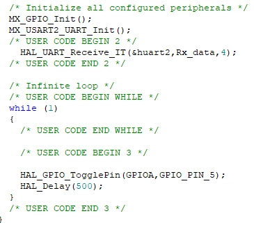

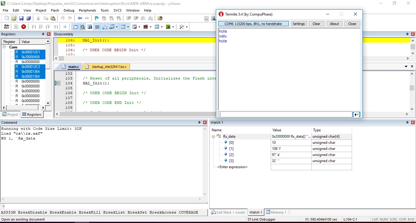

Receiver code
/* USER CODE BEGIN 0 */
//uint8_t Rx_data[10];
uint8_t Rx_data[4];
void HAL_UART_RxCpltCallback(UART_HandleTypeDef *huart)
HAL_UART_Receive_IT(&huart2,Rx_data,4);
/* USER CODE END 0 */
 MX_GPIO_Init();
 MX_USART2_UART_Init();
 /* USER CODE BEGIN 2 */
 /* USER CODE END 2 */

Then I use two different computers to load each part of the code, the transmission and reception and first execute the reception so that it is ready to receive and then the transmission code, however in the reception debbug I observe absolutely nothing.
When I run and test the transmitter code, I test it in this way.
When executing and testing the reception code, I test it in this way

Callback is done within the interrupt! That is where you get an incoming byte and you ve got to do something quick about it. Activate the IT from the main loop, add a 100ms delay, then transmit... For test
