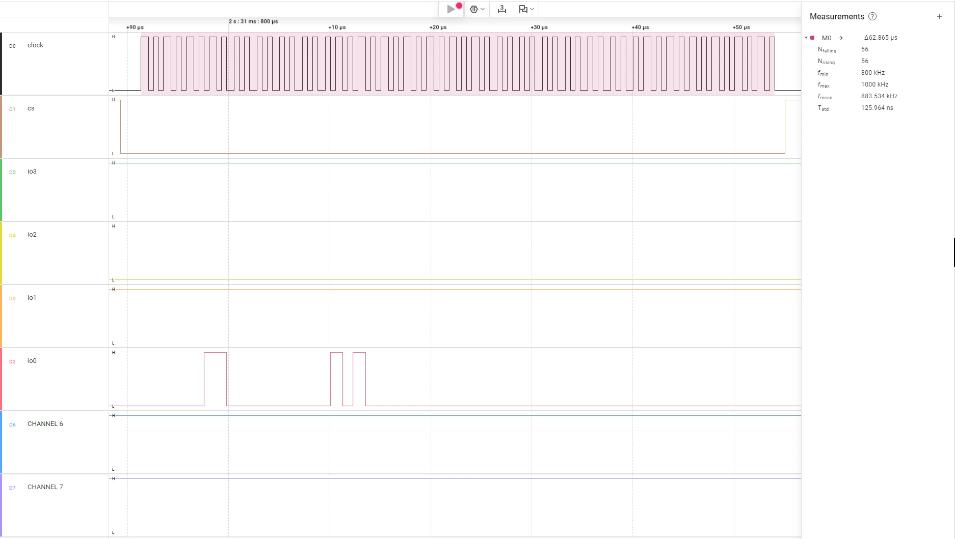

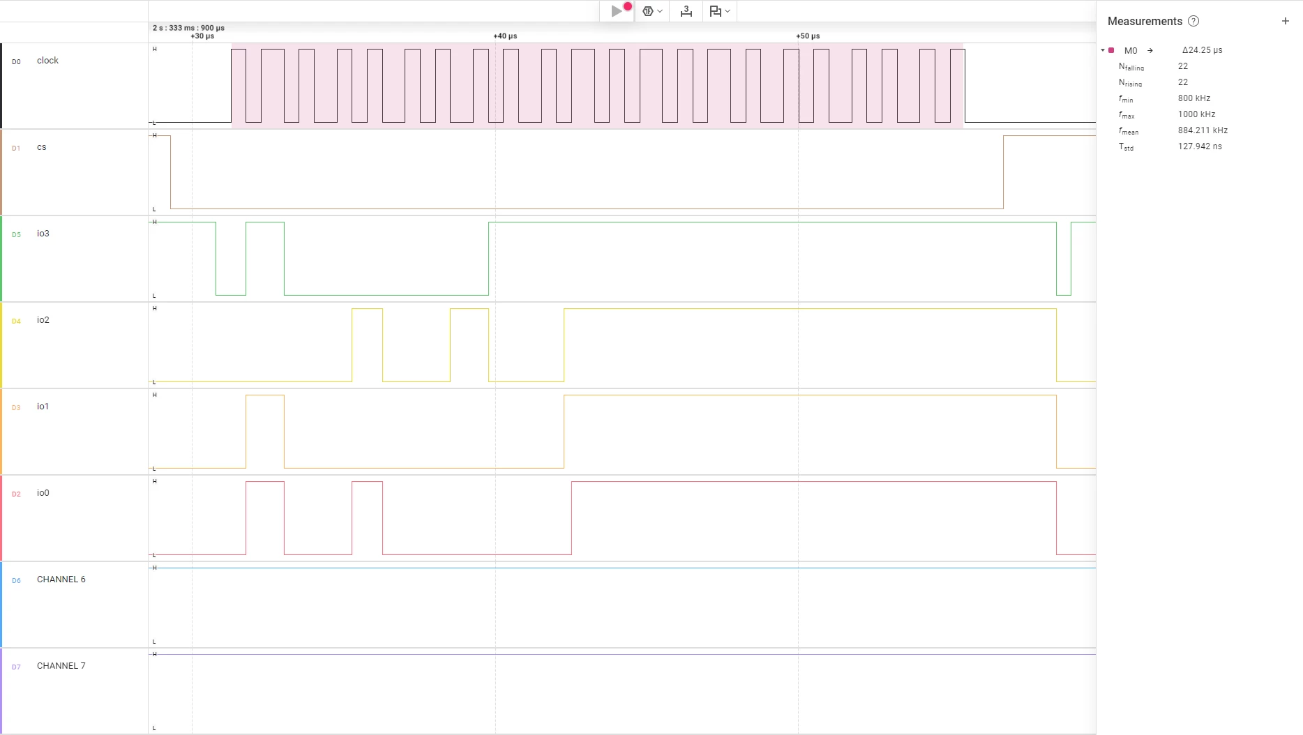

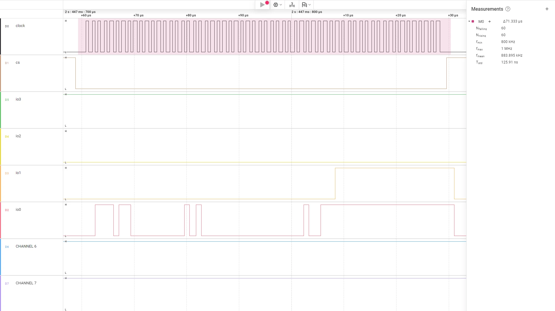

I am trying to establish communication between an STM32F446ZCH6 and a LAN9253 using the Quad SPI (QSPI) interface on our custom hardware.
As an initial validation, I am attempting to read the following LAN9253 registers:
  • BYTE_TEST register (0x64)
  • ID_REV (Chip ID) register (0x50)
However, I am not receive the expected register values. Instead, the values returned are consistently 0x88888888 or 0xFFFFFFFF.
To troubleshoot the issue, I captured the SPI/QSPI communication using a logic analyzer. From the waveforms, it appears that:
  • The STM32 (master) is transmitting the read command correctly.
  • The clock (SCK) and chip select (CS) signals appear normal.
  • However, the LAN9253 does not respond with valid data, and the STM32 does not receive any meaningful data from the slave.
We also attempted communication using:
  • Single SPI (1-bit mode)
  • Dual SPI (2-bit mode)
  • Quad SPI (4-bit mode)
Unfortunately, the behavior is the same in all three modes, with no valid response from the LAN9253.
We have verified the hardware and found the following:
  • LAN9253 supply voltage: 3.3 V (stable)
  • RESET pin: High (device is out of reset)
  • Crystal oscillator: 25 MHz, confirmed on the oscilloscope
One additional observation from the logic analyzer is that:
  • IO3 remains pulled high throughout the communication.
  • IO0, IO1, and IO2 remain low, and no response is observed from the slave device.
This is a custom board containing the STM32F446ZCH6 and LAN9253.
I will attach:
  • Logic analyzer waveform screenshots
  • Relevant source code used for the register read operation
Has anyone encountered a similar issue with the LAN9253? Are there any additional hardware checks, initialization steps, bootstrap requirements, or QSPI/SPI timing considerations that I should verify? Any suggestions would be greatly appreciated.
