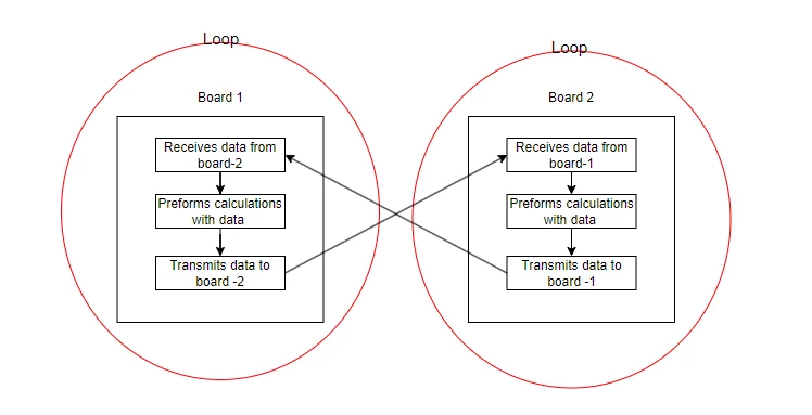

My project involves developing a controller design to manage different models on each STM32 microcontroller. The goal is to synchronize these controllers. I have successfully built the models, and they are functioning well. The key task is for each board to transmit data to another board. This data is crucial for calculations, leading to the generation of new data. This process of data exchange needs to be continuous. The image below shows how the each stm32 work.
Here's the challenge: I'm having difficulties with the data transmission and reception between the boards. The data, which is in double format.

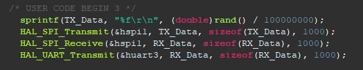

P.S. This is the code i am using for both boards. Just to check if i can transmit and receive at the same time.

So how are you connecting the 2 boards - UART? Other?
They key to this kind of thing is to not try to do both ends at once!
Start by getting one end working & fully tested against, say, a terminal in a PC.
Then get the other  end working & fully tested against, say, a terminal in a PC.
Then - and only then - bring the two together.

Use circular buffers to transmit pending data, and receive it.
Use a protocol like SLIP, which is self synchronizing, so that you can send packets back and forth. Feed whole packets to your processing loop.
Have some method to track if you've lost packets, and either request new copies, or have some recovery scheme to rebroadcast or heart-beat, should the link go down or lose bytes/synchronization.
The fundamental problem there is that you have no synchronisation between your sender & receiver.
You just arbitrarily send - without knowing that the other end is ready to receive!
As @Tesla DeLorean said, you need some sort of protocol to ensure that the receiver has received all that the sender sent - nothing more, and nothing less, and without errors.

You still haven't shown any diagram. With the two SPI devices, you need to have a ground reference, again without a diagram, we don't know if you wired it correctly.
With SPI bus, technically one of your boards needs to be configured as the Master and the other needs to be the Slave. The slave needs to be able to signal the Master there is data available to be sent to it. When the Master gets a signal (GPIO interrupt), the Master can clock the data from the slave to the master.
Without this signal, you can have the Master still clock data from the slave, but the slave may not have any valid data at that time. You could essentially get away without a signal from the slave but then you're now getting into writing a protocol, usually with a size/checksum to know you have valid packet.
