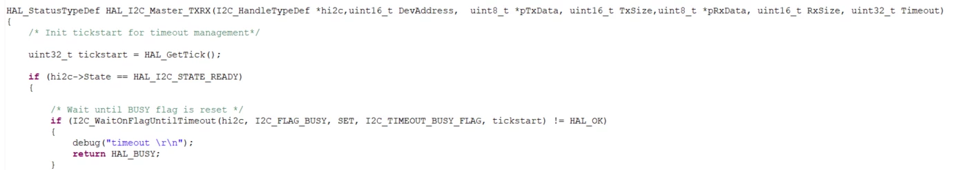

August 26, 2025
I am working on a stm32f412zgt6, when I use the HAL_I2C_Master_Transmit function I have a HAL_BUSY type error due to the following function, do you have any idea why?
