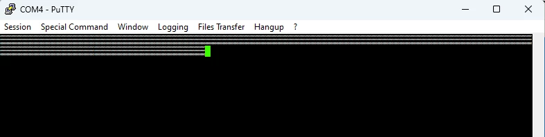

At the moment I'm working on a project using the STM32F4 discovery board that combines CAN2 and USART2. I managed to get them both working separately, but when I combine them in the same problem I get weird output on the serial monitor. When I then try my old program to only test the UART connection it works fine. Any ideas on why the combination of CAN and UART isn't working?

Rde K.1
Rde K.1Author
January 11, 2023
The serial output:
Javier1
Principal
January 11, 2023
Are you Reseting the canbus every time you run CAN_Polling() by any chance, if this is true ,why?
