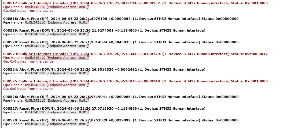

Ok, so I switched back to the example HID-device from STM32CubeIDE, but the mouse still doesn't work.

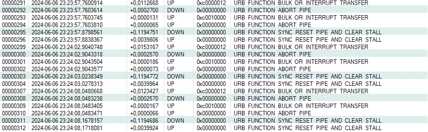

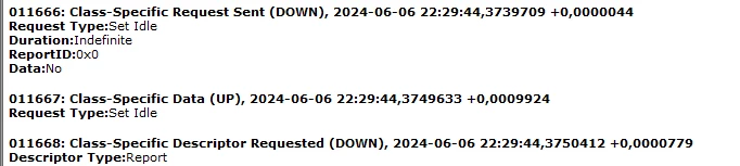

The descriptor including and its length are written into usbd_custom_hid.c. Rest of the code is the generated one from STM32CubeIDE. When using the mouse-code from above, no interaction:
- Descriptor with both keyboard ANDmouse: only keyboard example works
- Descriptor with mouse OR keyboard: the specified device works
I've also attached the project's code as a 7z-file.
duesentriebAuthorBest answer
Jun 7, 2024 3:14 PM UTC
Issue fixed by setting the HID_EPIN_SIZE in the file usbd_hid.c correctly.
