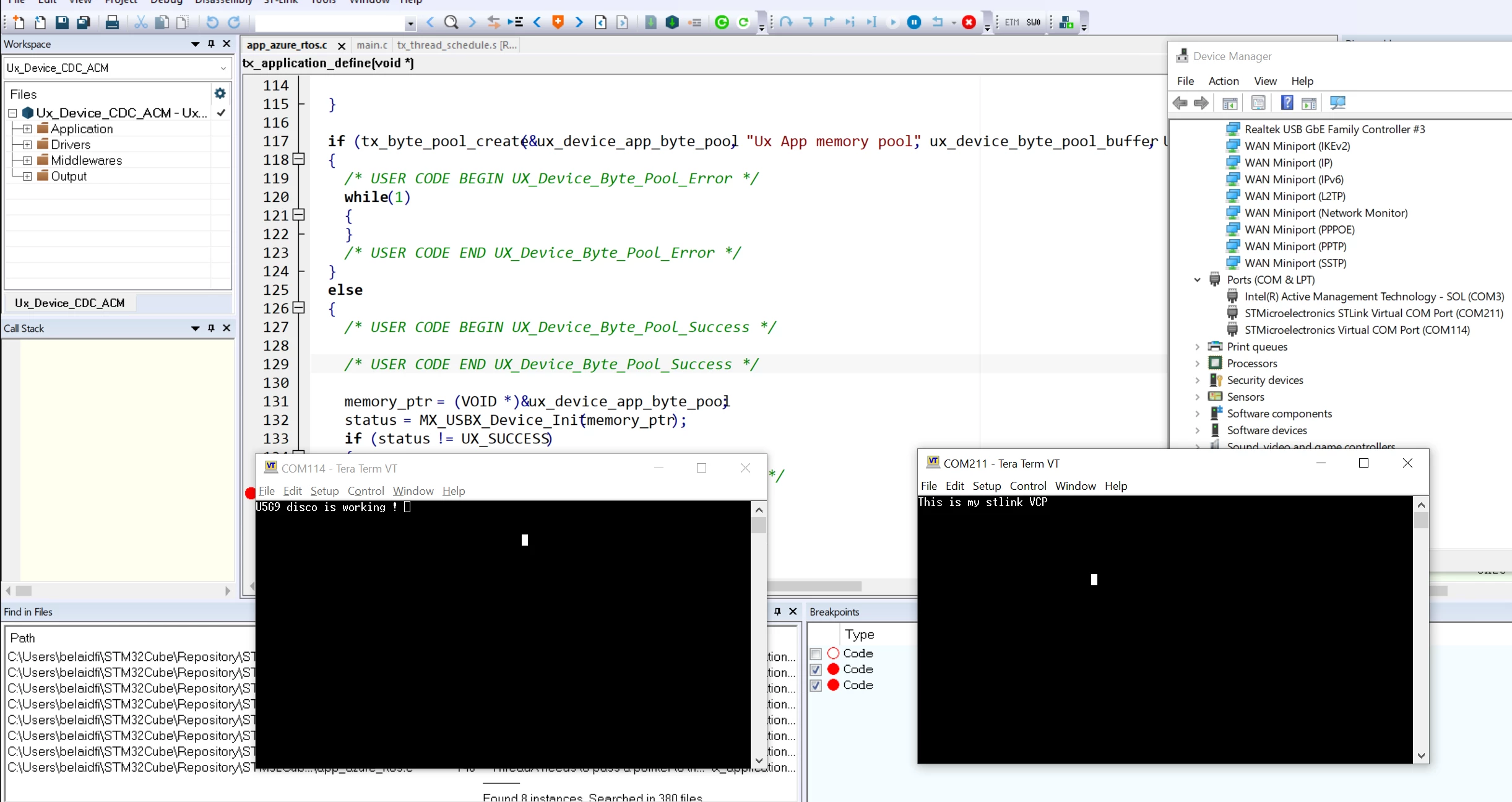

Hi @saikumar
You mean in this line?
The example is working on my end using MB1860-A02! Which revision is your board?
To give better visibility on the answered topics, please click on "Best answer" on the reply which solved your issue or answered your question.Best regards,FBL

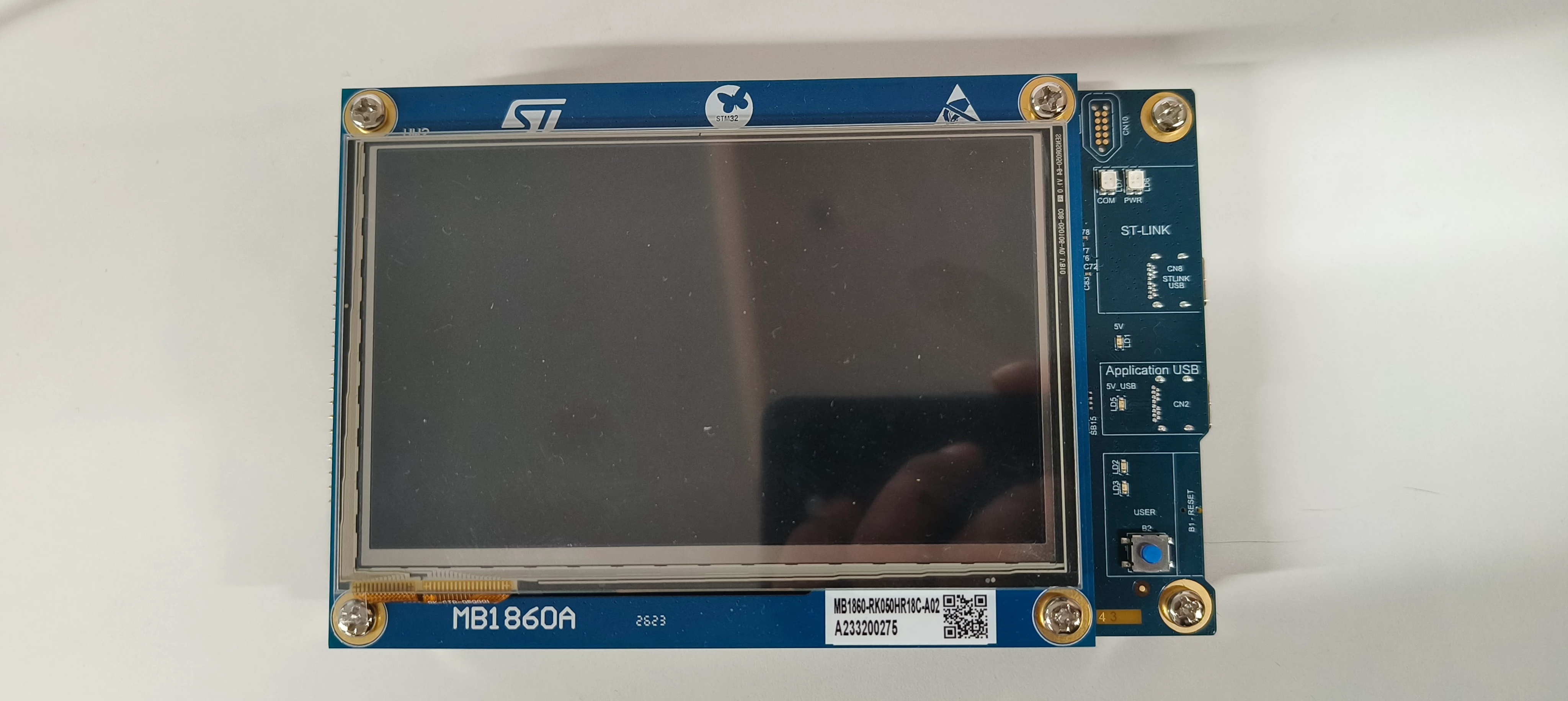

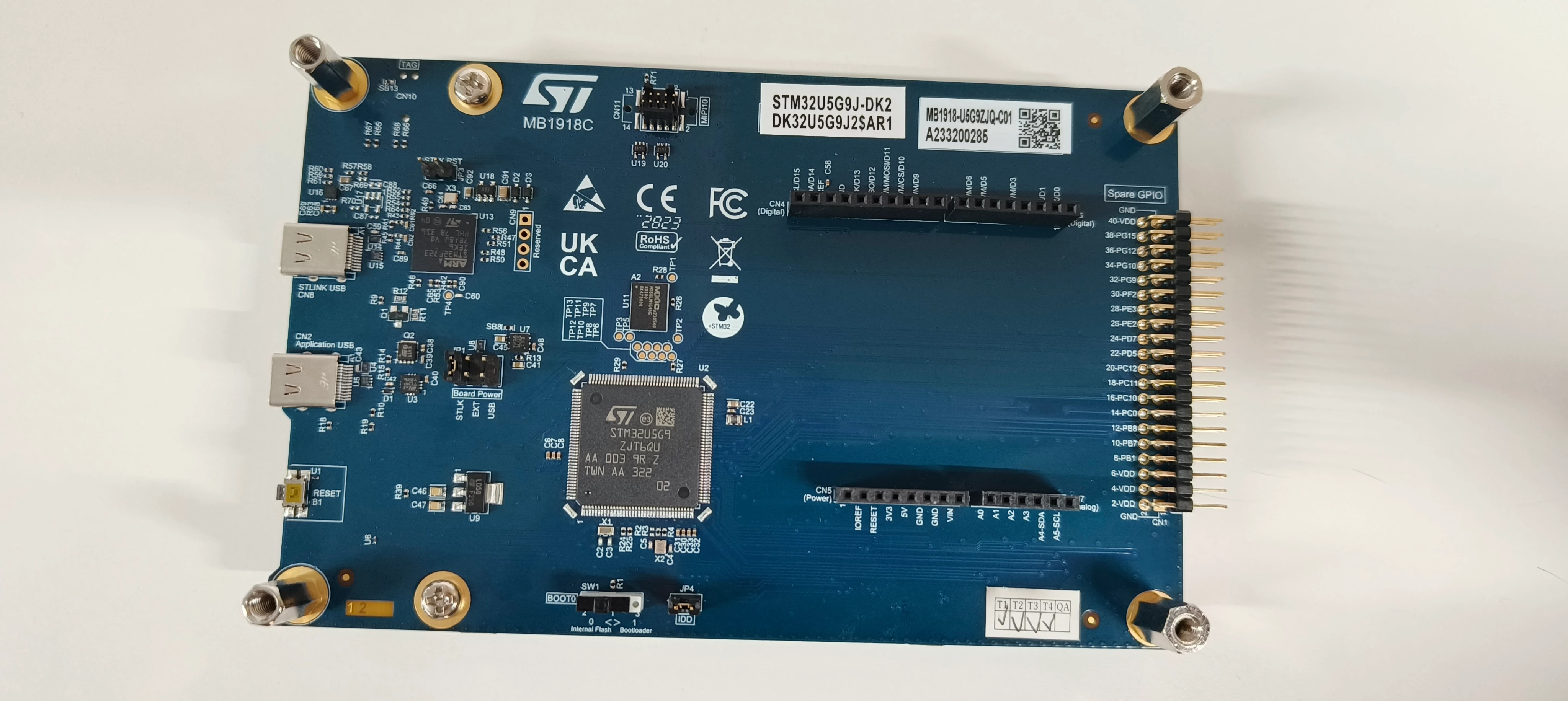

saikumarAuthor
Nov 20, 2024 4:56 AM UTC
Thank you for your reply Sir/Mam!
Yes, I am also using the same STM32U5G9-DK2 board, but I am encountering some issues:
1.  We haven't made any changes to the provided code and the hardware configuration.
2.  When we dump the code, only the ST-Link cable appears in Device Manager, but the USB application cable does not show up as expected.
It seems to be working on your side. Could you please let us know what changes you made to get it working?
I am sharing a photo of my board for reference. Is there any pin configuration or jumper setting that could be causing this issue?
Thank you for your assistance!
Nov 20, 2024 11:31 AM UTC
Hi @saikumar
No modifications have been made by my side. Ensure that you are using the latest version of the STM32Cube firmware package and USBX middleware. Do you connect the STM32U5G9J-DK2 board CN15 to the PC through "TYPE-C" to "Standard A" cable? You should see the LD5 lights up when powered by a USB host.
