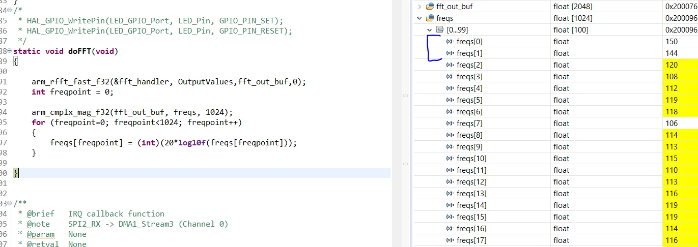

Hi everyone,

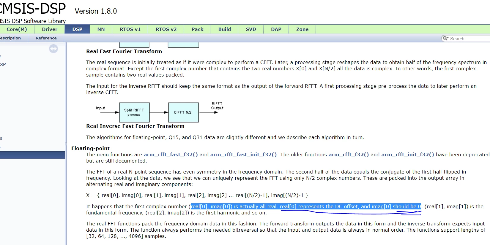

I am developing a sound acquisition node with MEMS-Microphone and everything works fine except that the FFT output not as it's supposed to be! even it's work and frequencies in the input data is detected good but imag[0] != 0 why? and it seems that real[0] doesn't represent the DC offset!
Any help?

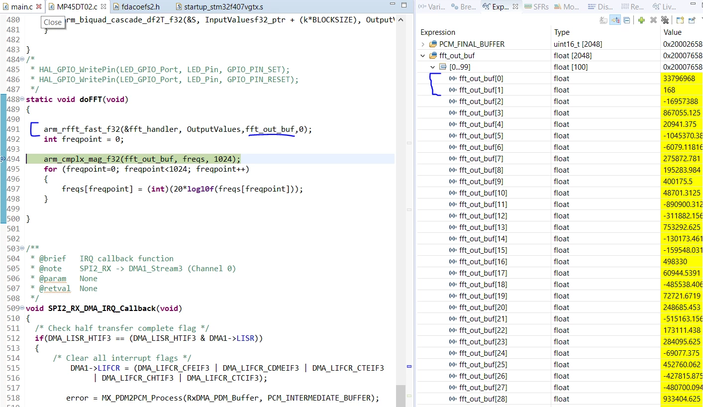

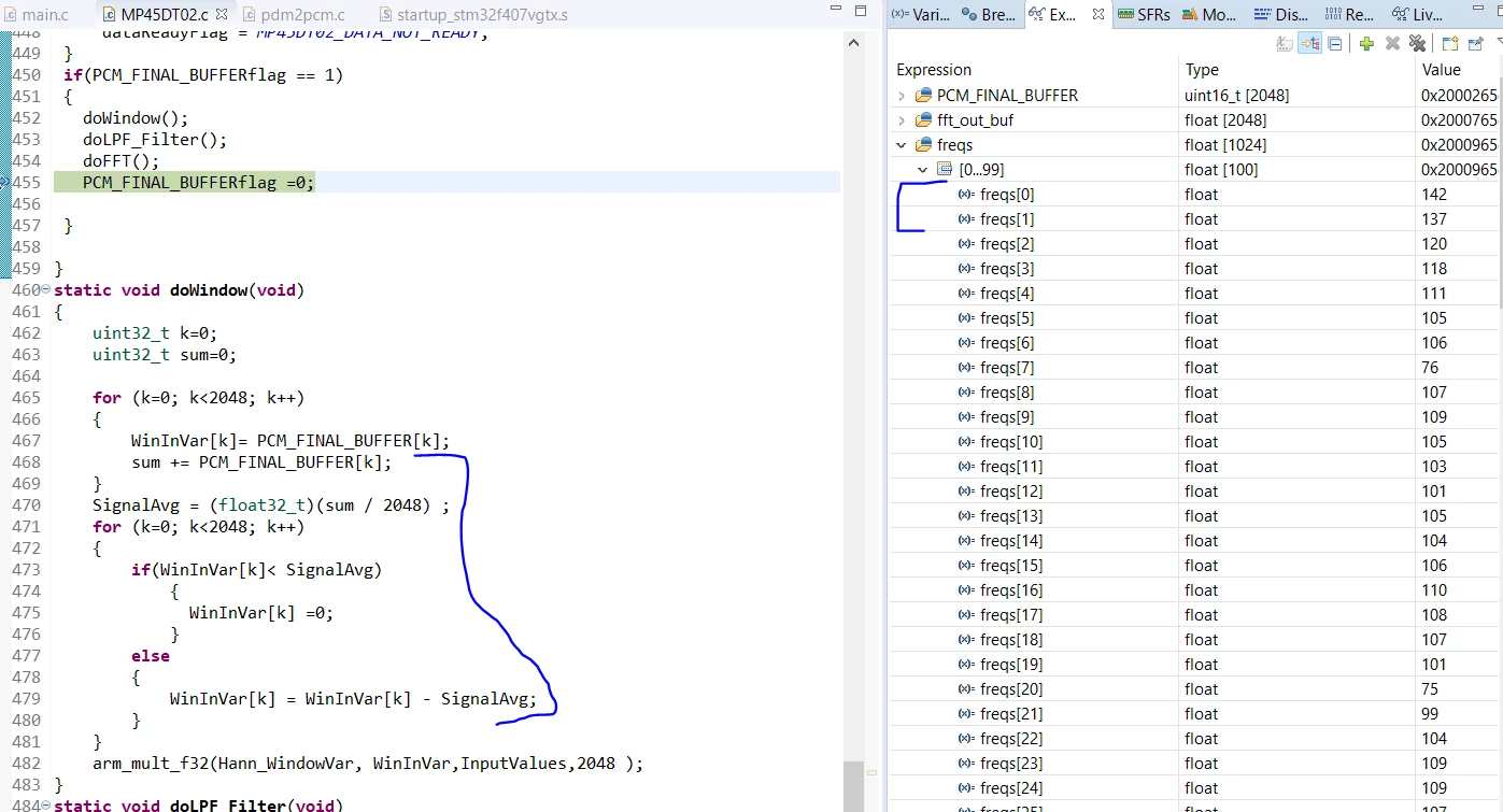

I already use HPF with cut-off frequency ~10Hz and also try to average the PCM data before windowing&filtering but still approximately the same!
Any suggestion?

A magnitude/phase representation of your data instead if re/im would be more clear.
If you use ADC input immediately, you will surely get a large DC component.
If you do any level-shifting to get your signal matching to the ADC input range, you need to correct that for the FFT.
