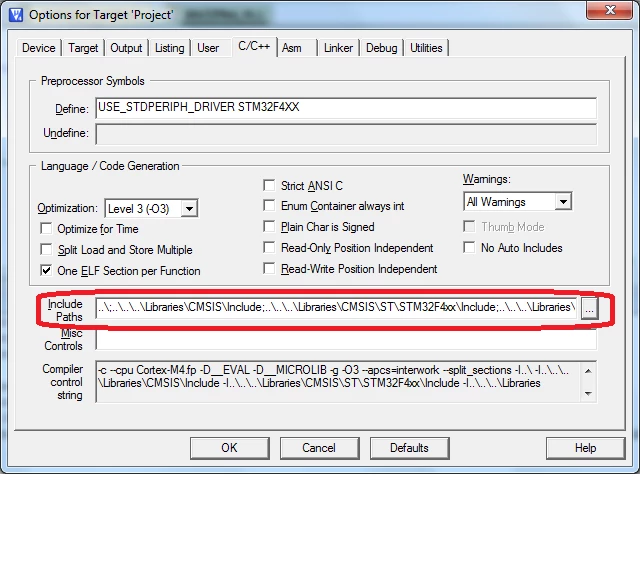

The error is not about adding library files, you need to set up the ''Include Paths'' for the project to point at the assorted directories you have include files stored in related to the project. If the inclusion isn't required you might also want to consider if you have the right defines for the project too.

You need the define ARM_MATH_CM4, otherwise is falls through and looks for an include you clearly don't have.
From the instructions in STM32F4xx_DSP_StdPeriph_Lib_V1.2.0\Libraries\CMSIS\Include\arm_math.h
* The library functions are declared in the public file <
code
>arm_math.h</
code
> which is placed in the <
code
>Include</
code
> folder.
* Simply include this file and link the appropriate library in the application and begin calling the library functions. The Library supports single
* public header file <
code
> arm_math.h</
code
> for Cortex-M4/M3/M0 with little endian and big endian. Same header file will be used for floating point unit(FPU) variants.
* Define the appropriate pre processor MACRO ARM_MATH_CM4 or ARM_MATH_CM3 or
* ARM_MATH_CM0 or ARM_MATH_CM0PLUS depending on the target processor in the application.

Changing the source code of the library is a rather bad idea.
Define ARM_MATH_CM4 on projects settings level, for instance in CPPFLAGS in the Makefile (or whatever your project is based on).
You might need to come to grips with you toolchain, the C language, and your build environment.

Not much into IAR, but you'll want the define globally, along with the USE_STDPERIPH_DRIVER, etc for the pre-processor.
The define clearly isn't being set, based on the include it's trying to pull in.

Now it seems to be pulling include files from within IAR rather than those pathed within the DSP library. Secondarily it is complaining about ''packed'' and needing extended language features enabled. As you're using IAR, you should probably seek support from them after you have reviewed the manuals/documentation for your tool chain.
Are there any pre built project examples within the DSP library?
