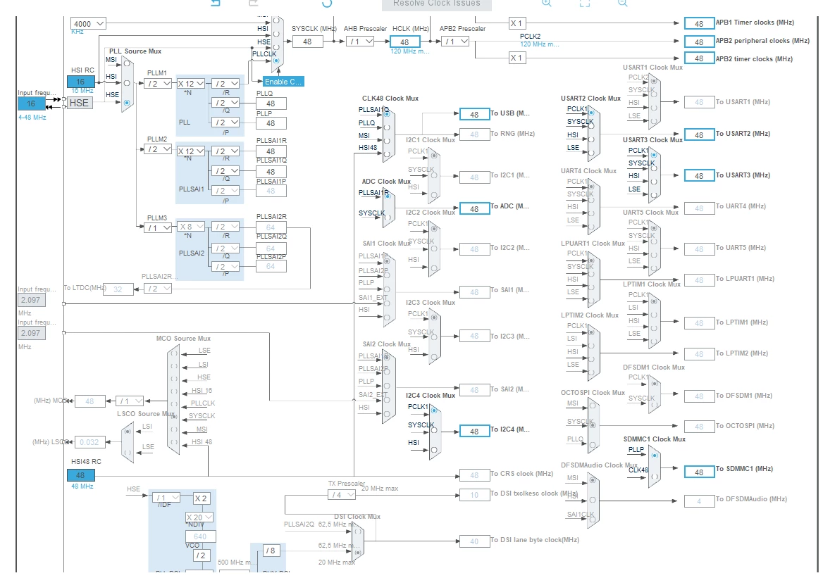

I would ask the community a suggestion for clock configuration.
I should use the USB ans Mass Storage Class using the SD card by SDMMC interface as memory. This function is used for 5 to 10% of my device usage, so I would decrease the SYSCLK for power consumption. Now it is set at 48 MHz.
Which could the right clock configuration to save power? I tried to simply set SYSCLK at 24 MHz but Storage is not recognized any more from Windows. Should I keep SYSCLK at 48 MHz as USB?

@Community member​ I tried this setting:
  • SDMMC Clock: 48 Mhz, Clock Divider 8
  • USB clock: 48 MHz
  • SYSCLK: 24 Mhz
Using the USB MSC the device is not recognize, while if I use SYSCLK = 48 MHz it is correctly recognized. Which could be a correct clock configuration in order to get a lower clock for power consumption?
