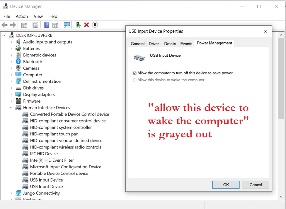

Sep 25, 2024 4:29 PM UTC
FBL,
Thank you for your suggestion.  As it turns out the problem was THE USB CABLE.  I had tried 2 Type-C USB cables that were supplied with certain cellphones and neither of them worked.  I got a brand new Type-C USB cable that is labelled "Gadget Gear 2023 Type-C Sync and Charge Cable" and it is now working.
FYI - your suggestion is problematic.  I found that the section for "Allow this device to wake the computer" is grayed out (Windows 10):

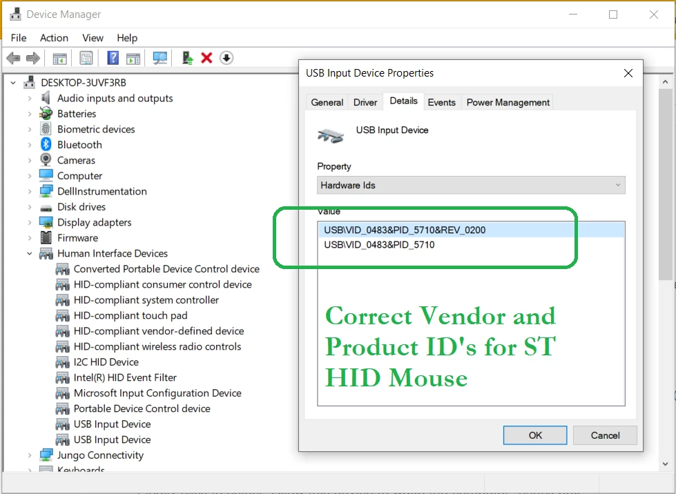

I found this under "Human Interface Devices".  This is the correct vendor and product ID:

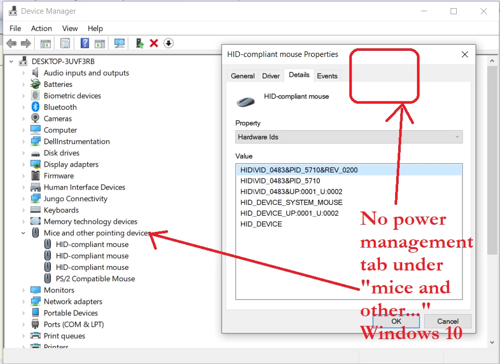

And also interestingly, I found that under "mice and other pointing devices" (Windows 10) there is no tab for power management at all, so the instructions that you gave are also not compatible with Window 10 (or at least my instance of it):

Sep 27, 2024 2:20 PM UTC
Hi @PaulBerland
This feature can be configured in dev_remote_wakeup in USB device desc parameters. FYI, you can find it under usbd_def.h
