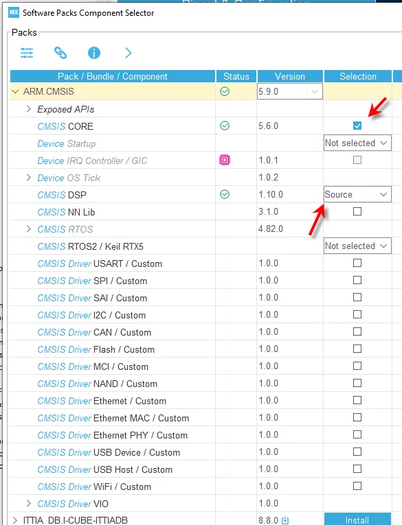

I just started a new project and wanted to use CMSIS 5.9 - as it finally can be installed from the package without errors.
Until now I only used CMSIS 5.7 als library, which worked pretty well. Unfortunately since 5.9 there is no library availiable, which could be included so I had to select "source" in the CubeMX Setup:
CubeMX CMSIS SetupCubeMX CMSIS Setup
The only difference to CMSIS 5.7 as I used it previously is, that I selected "source" for the DSP component and of course the version 5.9

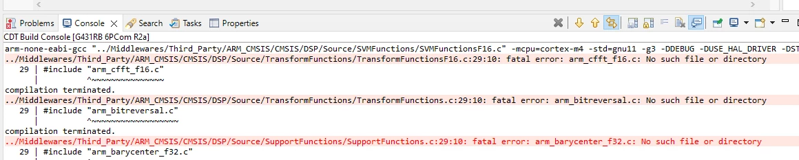

I wrote a simple test programm and tried to compile it. The result is a lot of missing dependencies:
console outputconsole output
it is e.g. complaining about:
./Middlewares/Third_Party/ARM_CMSIS/CMSIS/DSP/Source/SupportFunctions/SupportFunctions.c:29:10: fatal error: arm_barycenter_f32.c: No such file or directory
or
../Middlewares/Third_Party/ARM_CMSIS/CMSIS/DSP/Source/SupportFunctions/SupportFunctionsF16.c:29:10: fatal error: arm_copy_f16.c: No such file or directory

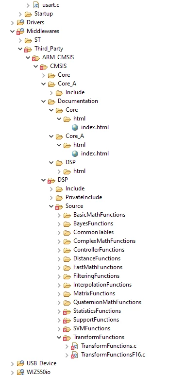

project treeproject tree

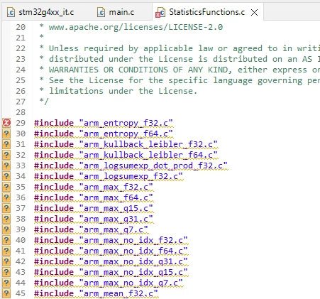

if I open one of these files, it is just the tip of the iceberg, there are lots of missing dependencies:
StatisticsFunctions.c e.g. wants to include lots of *.c files, which are non existant in the project.
I have added ../Middlewares/Thrid_Party/ARM_CMSIS/CMSIS to the incude directories in the Project setup, with no result - which is obvious because the included files do not exist in the project folder.

By the way: if I select CMSIS in the CubeMX Project Setup, it automatically creates a link to the source folder "CMSIS" in the project path, but the folder is not created. So at the first start of a project with CMSIS a problem notification pops up. My solution so far was to create an empty folder named CMSIS, then the problem notification disappeared. Does this eventually mean CubeMX / CubeIDE expects me to add my version of CMSIS manually to the project? I'd expect that CubeMX would do this automatically, if I select CMSIS Base and DPS in the Setup. But you never know ...
