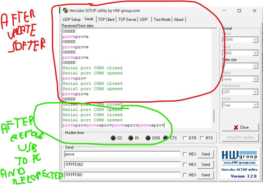

Changing UART operating method on STM32G431KBU6
Hi Guys, I'm working on a personal project. I have experience with the use of STM Nucleo and this time I don't know how to get out of my problem. Previously I have already used the UART peripheral in the same way that I am using it now, but now it has a really strange behavior. I loaded the software on the nucleo I open Hercules (Program to send data to the uart) and everything works perfectly when sending the message "prova" I see that everything has been received correctly because I receive the same message sent plus a confirmation "prova
OKKKK
". Now I remove the USB from the Nucleus and turn the card back on, now it works differently... when I send "prova" I receive "aprov", in fact if I look at the char array before removing the power supply it contained data[0]=112, data[1]=114, data[2]=111, data[3]=118, data[4]=97 now instead I find data[0]=97, data[1]=112, data[2]=114, data[3]=111, data[4]=118. How is it possible that the operation has changed once the USB was removed from the PC and reinserted?
How is it possible that after loading the software it behaves in one way and if I remove the USB from the PC and put it back it behaves in another. I need urgent help thanks.

I expect the STM32 is seeing a character before the "p". The STM32 is responding with 5 characters but we only see "prov", and the "a" comes on the next transmission. If you can show hex values intead of ASCII characters, you would probably see this. Are there external pullups on the line?
Consider using HAL_UARTEx_ReceiveToIdle instead in order to re-synchronize when the line is idle, assuming your terminal program sends characters with no delay in between.
Aug 15, 2024 12:12 PM UTC
Hello @MBertocchi ,
Using the same buffer for both reception and transmission can indeed cause issues, especially if the buffer is being modified or accessed concurrently by different parts of your code.Use separate buffers for reception and transmission to avoid conflicts. Also try adding a null character at the end of the received data to safely use it as a string (declared as size 6 and add dato[5]='\0').
you can refer to the example for Uart in STM32Cube_FW_G4_V1.5.2\Projects\NUCLEO-G431RB\Examples\USART\USART_SlaveMode
Regards
Senior III
Aug 15, 2024 2:51 PM UTC
For reliability you need to have start of frame and end of frame with special character sequences.  Otherwise, once it gets locked to some wrong sequences, it's lost for ever. Wrong data can enter due glitches, reboot etc.
Karl Yamashita
Aug 16, 2024 3:04 AM UTC
You're data is being received out of sync. As mentioned, you probably have an unknow character received when you connect the USB.
To get around this, you should received 1 byte at a time and save to a queue buffer. Be sure your string has a terminating character like a LF. That way you can sync each message into it's own queue.
Below is an example of a queue of 4 messages with a character count of 32.
Even if the string is greater than 32 bytes, it'll still buffer the message into multiple queues and transmit the queue FIFO.
