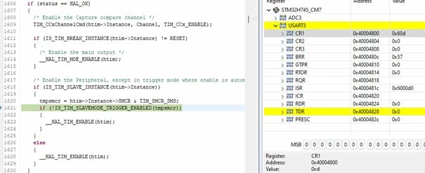

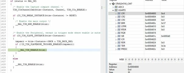

I found a strange behaviour now in my code. When I initialize my UART3, I can communicate with my terminal as expected. During runtime, I call the function HAL_TIM_PWM_Start_IT() to start timer 1. After this call, the received characters are not same as before. When I step through the code, I found within the HAL_TIM_PWM_Start_IT() function the call to enable the timer (line 1623), which causes this change of my parity settings.

0693W00000Y97c6QAB.pngWhen I start debugging, it ends here in stm32h7xx_hal_tim.c (lines are added by me, just for this box).
1620 tmpsmcr = htim->Instance->SMCR & TIM_SMCR_SMS;
1621 if (!IS_TIM_SLAVEMODE_TRIGGER_ENABLED(tmpsmcr))
1622 {
1623 __HAL_TIM_ENABLE(htim);
1624 }

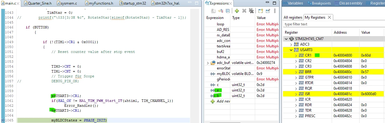

Register from UART3 before
0693W00000Y97VQQAZ.jpgand after the function call.

As you can see in the register settings, the bit UEN in register USART_CR1 is set to one. In the datesheet (pg. 2251 from RM0399), it is written "This bitfield can only be written when the USART is disabled (UE=0)." I wonder why changing of these bits is possible?

It is really strange, it looks, it is a little bit time delayed, when the change is happend. When I readout the settings, the original value is still in. But the debugger is showing the changed register.
