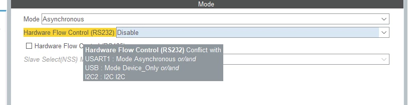

thanks for your reply. I have no output on serial. Now i've noticed that maybe there is a conflict in pinout definition: if I set uart1 as PB6 and PB7 directly in the .ioc config, I can see that USART1 definition has a warning:
I will try to solve this

Feb 13, 2025 9:24 AM UTC
yellow is only a warning (hint) that not all options for Hardware Flow Control will be available, because some will conflict with other settings.
Debug-step through your code and compare the actual register settings with the expected ones.
hth
