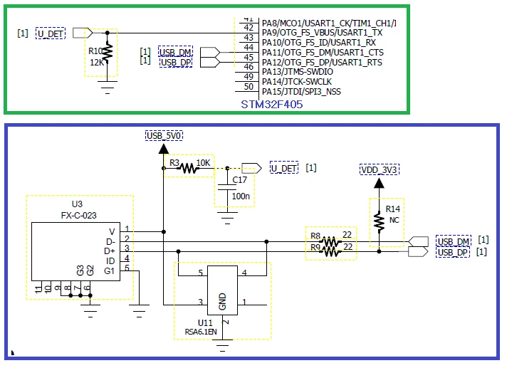

I'm using the STM32CubeMX 4.3.0 version.I created a project for CDC Virtual COM port for STM32F405RG micro. I need full duplex communication. Please find the attached CubeMX project .ioc file.
Following is the USB schematic of the board. 0690X000006058ZQAQ.png Generated code for IAR EWARM. The generated code has the following functions to receive & transmit data.
