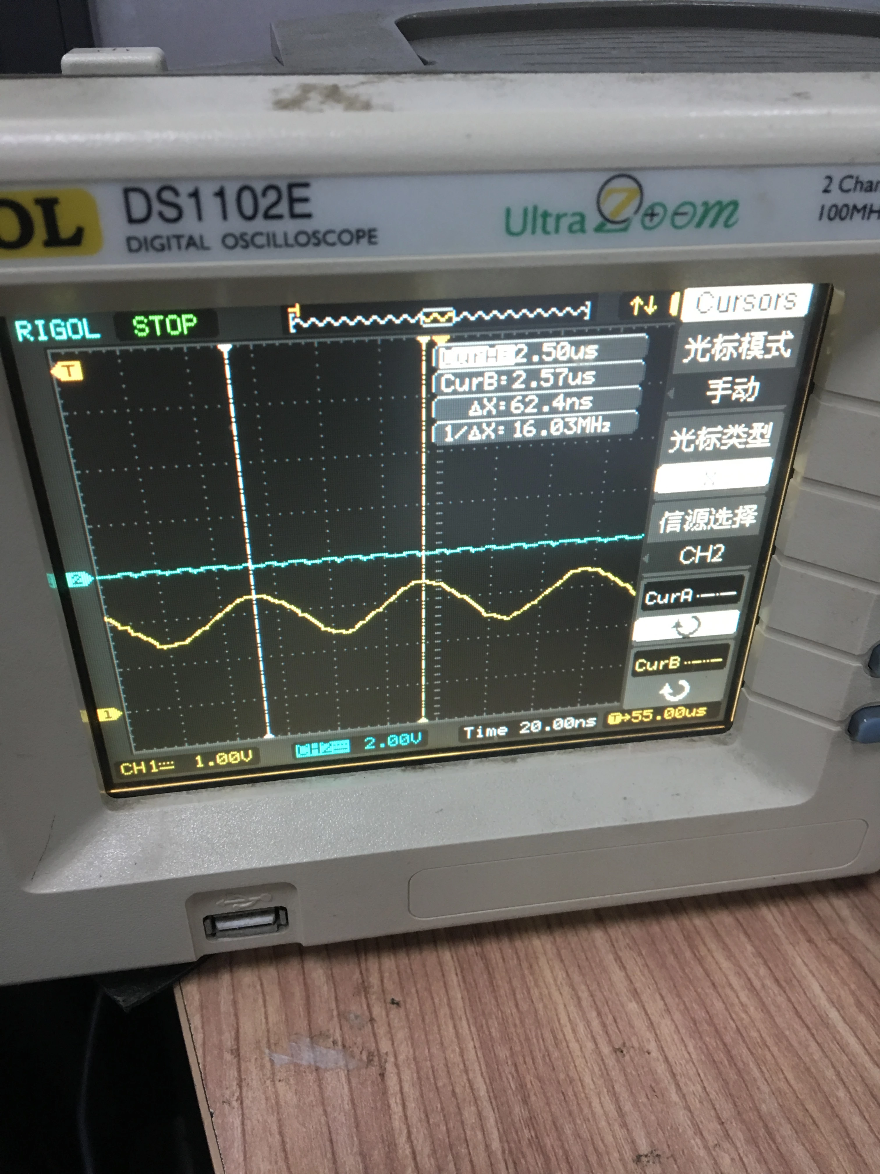

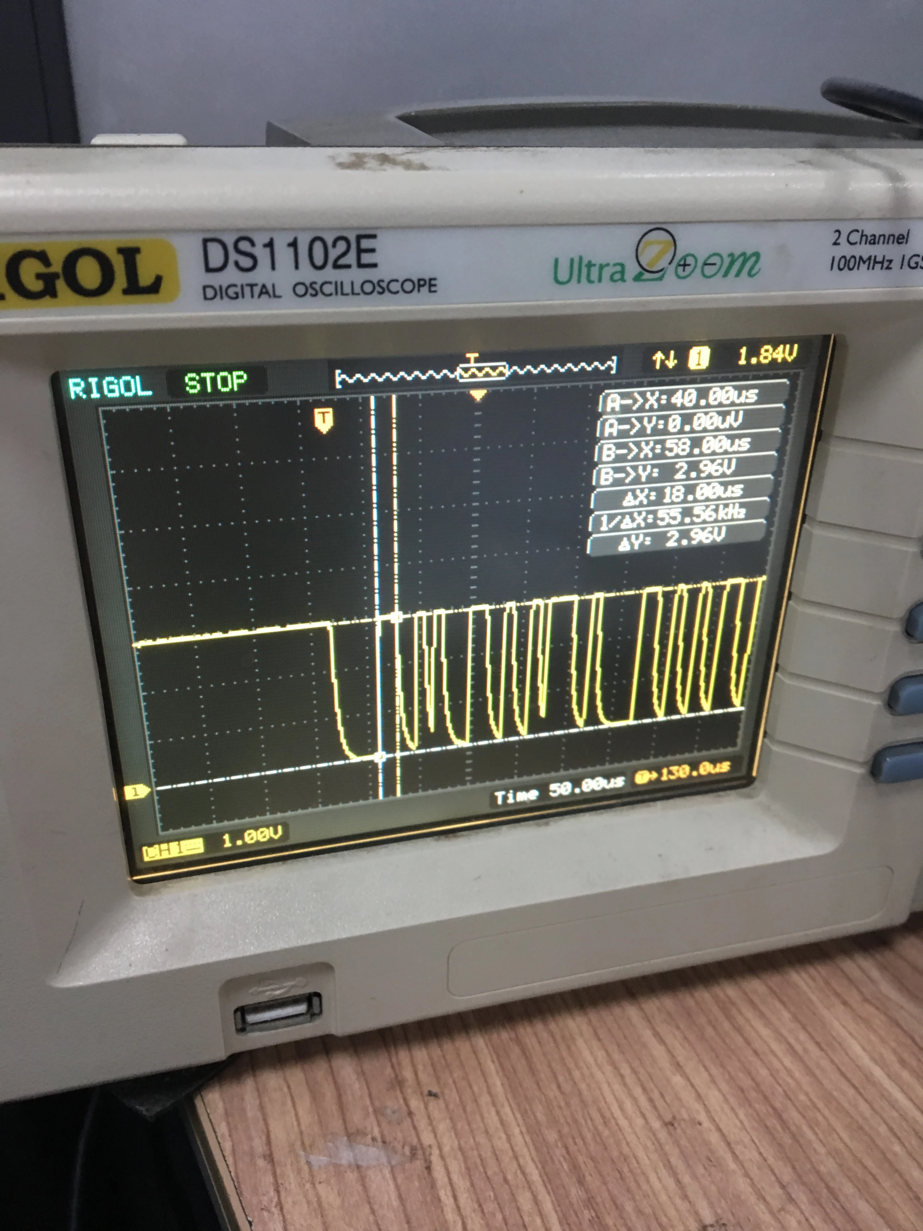

Treacy Yao
Jul 17, 2019 11:51 AM UTC
Sorry that I don't understand your meaning clearly. I check the HSE and USB D+ frequency. Please have a check.0690X000009Ypn0QAC.jpg0690X000009YpmqQAC.jpg
Trevor Jones
Senior
Jul 17, 2019 12:18 PM UTC
very difficult to see the voltage of the crystal, and the frequency is not exactly 16MHz ? it should be 16.00 I would expect.
now check in the cube, is the HSE selected as the clock source ?
check it all the way to the usb clock 48MHz inside the cube clock configuration page.
