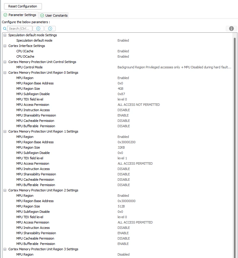

 /* MPU Configuration */
void MPU_Config(void)
 MPU_Region_InitTypeDef MPU_InitStruct = {0};
 /* Disables the MPU */
 HAL_MPU_Disable();
 /** Initializes and configures the Region and the memory to be protected
 MPU_InitStruct.Enable = MPU_REGION_ENABLE;
 MPU_InitStruct.Number = MPU_REGION_NUMBER0;
 MPU_InitStruct.BaseAddress = 0x0;
 MPU_InitStruct.Size = MPU_REGION_SIZE_4GB;
 MPU_InitStruct.SubRegionDisable = 0x87;
 MPU_InitStruct.TypeExtField = MPU_TEX_LEVEL0;
 MPU_InitStruct.AccessPermission = MPU_REGION_NO_ACCESS;
 MPU_InitStruct.DisableExec = MPU_INSTRUCTION_ACCESS_DISABLE;
 MPU_InitStruct.IsShareable = MPU_ACCESS_SHAREABLE;
 MPU_InitStruct.IsCacheable = MPU_ACCESS_NOT_CACHEABLE;
 MPU_InitStruct.IsBufferable = MPU_ACCESS_NOT_BUFFERABLE;
 HAL_MPU_ConfigRegion(&MPU_InitStruct);
 MPU_InitStruct.Number = MPU_REGION_NUMBER1;
 MPU_InitStruct.BaseAddress = 0x30000200;
 MPU_InitStruct.Size = MPU_REGION_SIZE_32KB;
 MPU_InitStruct.SubRegionDisable = 0x0;
 MPU_InitStruct.TypeExtField = MPU_TEX_LEVEL1;
 MPU_InitStruct.AccessPermission = MPU_REGION_FULL_ACCESS;
 MPU_InitStruct.IsShareable = MPU_ACCESS_NOT_SHAREABLE;
 MPU_InitStruct.Number = MPU_REGION_NUMBER2;
 MPU_InitStruct.BaseAddress = 0x30000000;
 MPU_InitStruct.Size = MPU_REGION_SIZE_512B;
 MPU_InitStruct.IsBufferable = MPU_ACCESS_BUFFERABLE;
 /* Enables the MPU */
 HAL_MPU_Enable(MPU_PRIVILEGED_DEFAULT);

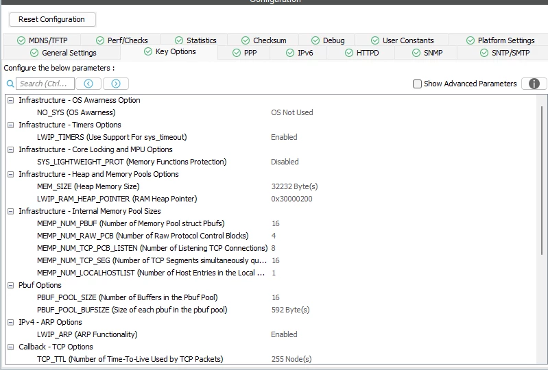

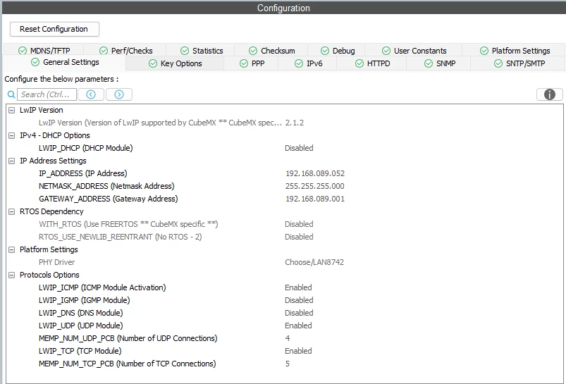

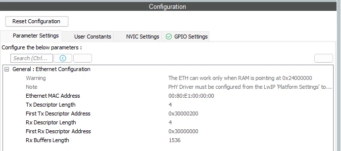

  •  ETH conf in CubeMX: DavidWahlberg_0-1716890710911.png
  • MPU conf in CubeMX:DavidWahlberg_1-1716890788039.png
  • LWIP conf in CubeMX:DavidWahlberg_2-1716890822375.pngDavidWahlberg_3-1716890840980.png
Any suggestions?

May 29, 2024 4:22 PM UTC
Hello @DavidWahlberg ,
I recommend you check the following Example STM32Cube_FW_H7_V1.11.0\Projects\NUCLEO-H723ZG\Applications\LwIP\LwIP_TCP_Echo_Server\ as a reference because at first glance you are missing some necessary steps and the MPU config as well is not in line with the example.
BR
