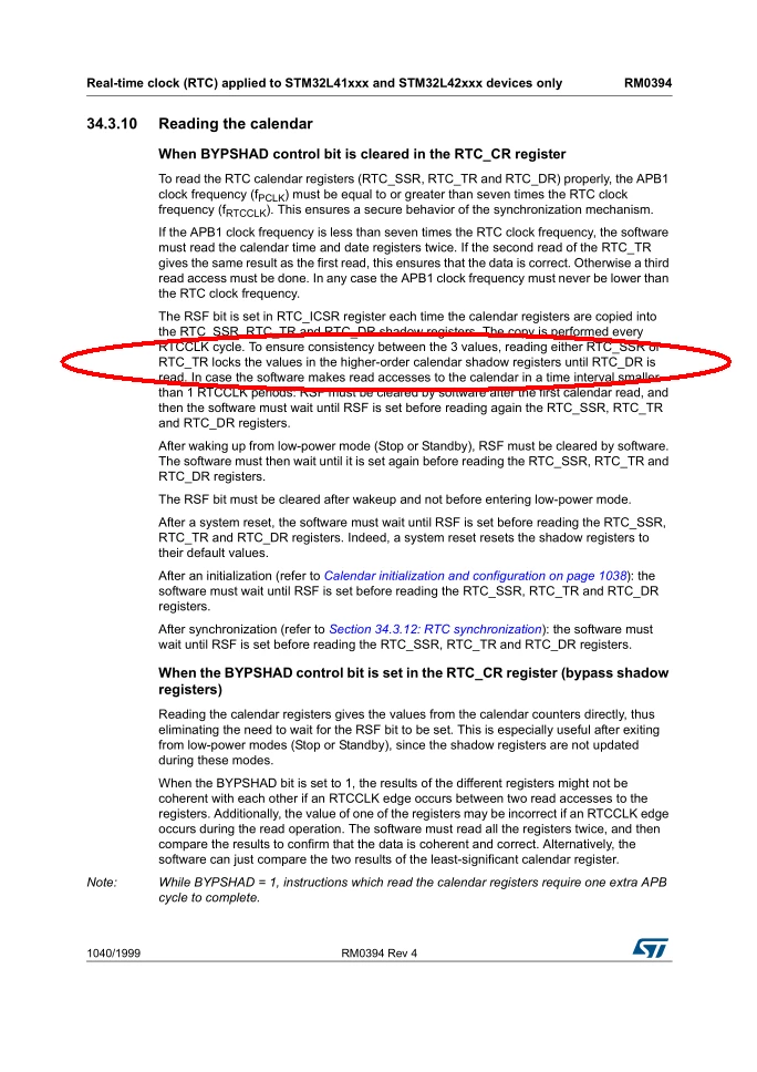

I seem to be unable to set the time more than once after reset. Here is a way to reproduce my problem:
  1. Create a new CubeMX project with the RTC enabled
  2. Edit the MSP init function the following way:
  3. ...After the time and date are set by MSP init
  4. ...change the hour in the sTime structure, e.g. sTime.Hours = 0x09;
  5. ...and then issue HAL_RTC_SetTime(&hrtc, &sTime, RTC_FORMAT_BCD);
  6. ...and then issue HAL_RTC_GetTime(&hrtc, &sTime, RTC_FORMAT_BCD);
  7. run the code in the debugger and break in the new readTime call from step 6
  8. note that the value of hour has not changed

I found this on some spanish website for the F439xx HAL, and it fixed the problem:
  • You must call HAL_RTC_GetDate() after HAL_RTC_GetTime() to unlock the values in the higher-order calendar shadow registers to ensure consistency between the time and date values. Reading RTC current time locks the values in calendar shadow registers until Current date is read.
By adding HAL_RTC_GetDate immediately after the GetTime on line 4 (above), the code works.
Unfortunately, I couldn't find this useful tidbit in the 412KB reference manual.

 > Unfortunately, I couldn't find this useful tidbit in the 412KB reference manual.
This is the very purpose of having shadow datetime registers at all.
However, FYI, this mechanism is flawed in most STM32, see RTC calendar registers are not locked properly erratum in many STM32 errata. It's hard to tell whether this applies to the 'L412 too - it's latest (and only) errata are dated 2018 while the above erratum is dated late 2016; but ST refuses to publish detailed list of IPs versions used in individual families/models.
PS. It's also documented in Cube in the doxygenoid "header" to HAL_RTC_GetTime(), in the current (April 2020) version https://github.com/STMicroelectronics/STM32CubeL4/blob/master/Drivers/STM32L4xx_HAL_Driver/Src/stm32l4xx_hal_rtc.c#L859
