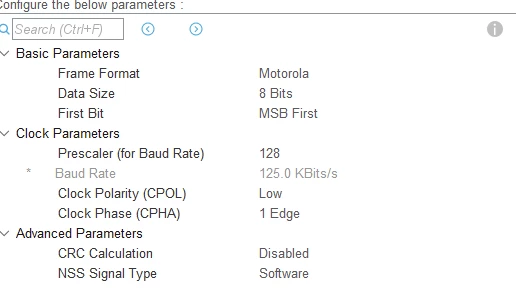

I'm trying to interface an SD card over SPI with an STM32F411. However, I cannot even initialize it. My current sequence is:
  1. Wait 20 ms after power-on.
  2. Send 10 clock cycles with CS high.
  3. Pull CS low and send CMD0 and wait for a reponse.
Instead, I only ever receive 0xFF instead of 0x01.
My SPI configuration looks like this:
Here is the relevant code:

Best answer by estedebain
Hello Saket_om,
So in the end it randomly started working, after connecting it to an oscilloscope, the signals look similar. Maybe some jumper cable was broken?
Thank you!

Hello @estedebain
Did you try to check what happening on the bus using logic analyser? Is the SPI sending the CMD?
In order to give better visibility on the answered topics, please click on 'Best answer' on the reply which solved your issue or answered your question. Saket_Om

September 3, 2025
Hello Saket_om,
Thank you!
