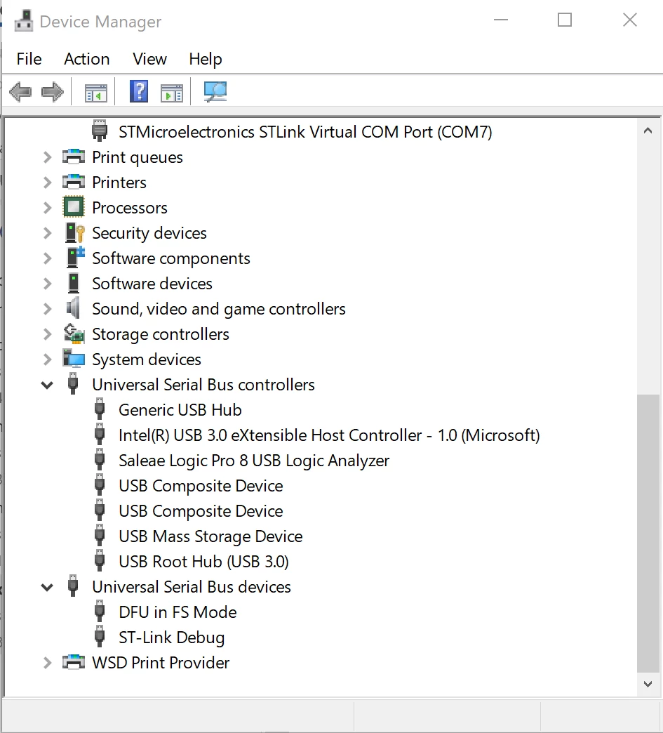

I believe I am in the ST bootloader because if I plug a USB cord into the computer on the bottom USB (not the top ST-Link USB), DFU FS Mode shows up in the device manager. I am performing a power cycle between each iteration of testing for trying to enter the SPI Bootloader mode to prevent testing SPI sequences and accidently entering the wrong mode.

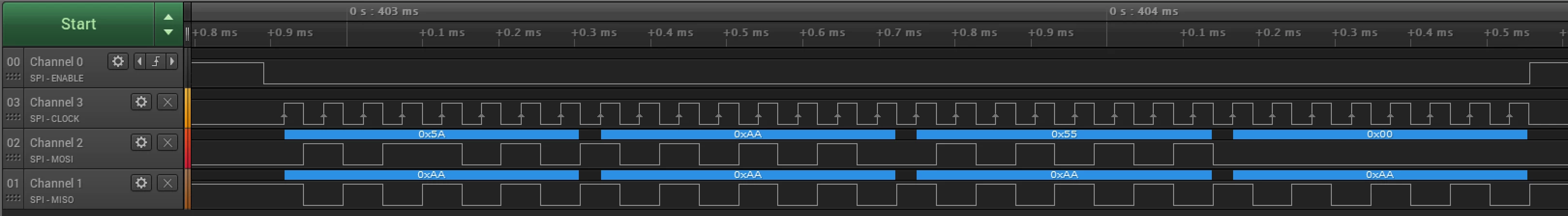

0693W000006FBZ6QAO.png0693W000006FBYrQAO.png0693W000006FBZGQA4.pngAfter power cycling and waiting more than 2-3 seconds (watching for the 1 second of yellow LED flashing I have added before the jump the bootloader) I start the following SPI communication:
MOSI MISO
0x5A  0xAA
200ms Delay
0x00  0xAA
200ms Delay
0x5A  0xAA
0xAA  0xAA
0x55  0xAA
0x00  0xAA

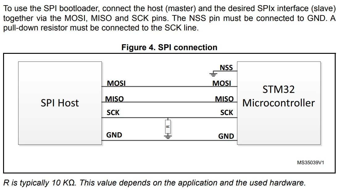

My physical connection for the SPI is the same as Figure 4 in AN2606 Rev 46:
0693W000006FBZVQA4.pngI am using two 22kOhm resistors in parallel measured to be 10.8kOhm for the pull down resistor on the SCK line.
I have triple checked the connections and I am even using the same color coded breadboard jumper wires to verify everything is connected as represented below.
Connected to PE11, PE12, PE13, PE14 located on CN10. CN10 pins 6, 8, 10, 26.
CS     | PE11 |CN10 Pin 6   | Channel 0
SCLK | PE12 |CN10 Pin 26 | Channel 3
MISO | PE13 |CN10 Pin 10 | Channel 2
MOSI | PE14 |CN10 Pin 8   | Channel 1
GND | GND |CN10 Pin 5 | Connected to FT232H ground

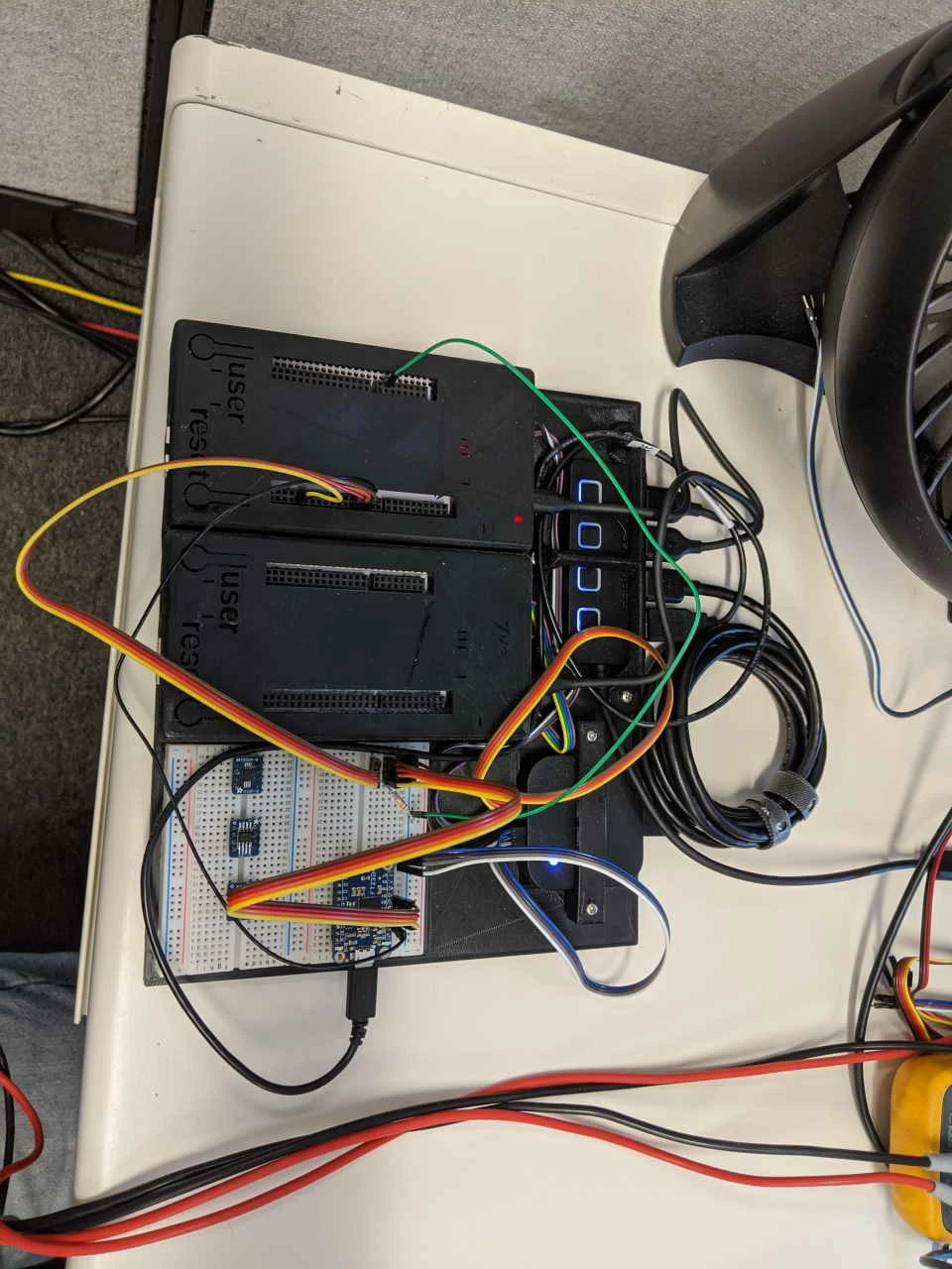

Here is my setup.

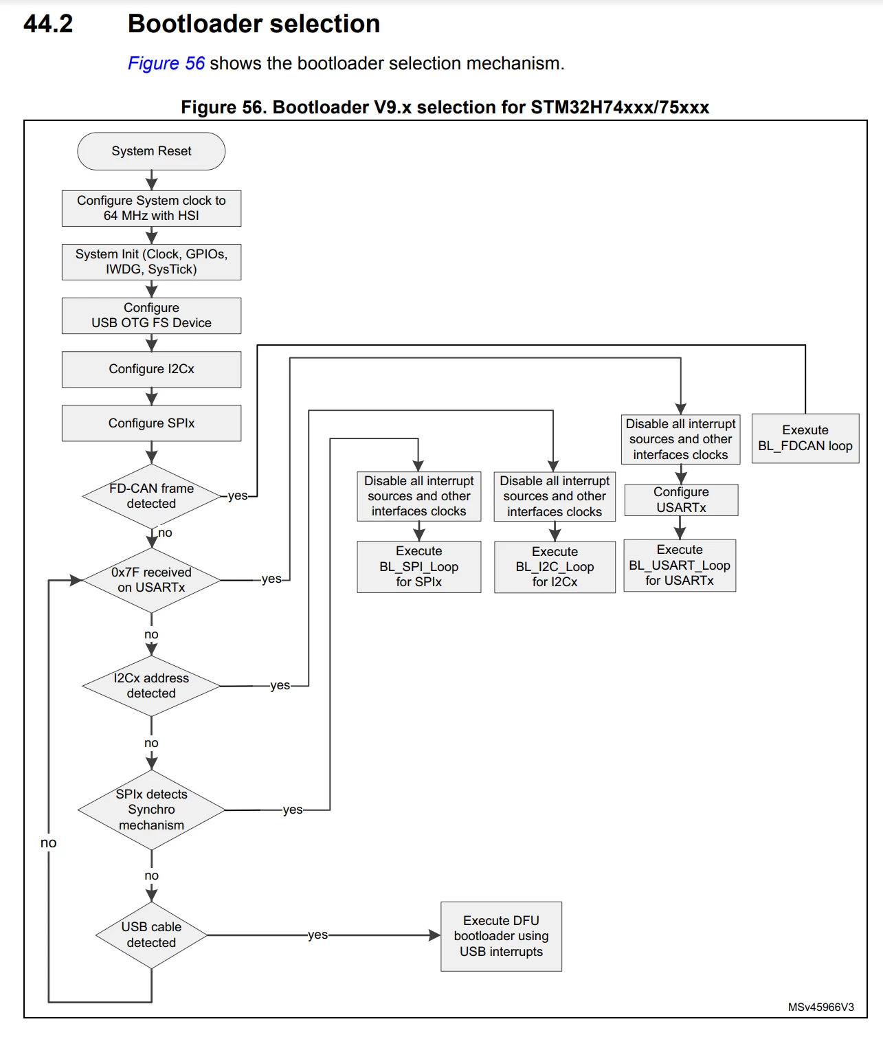

My next step is taking every pin that is an input while in the bootloader mode and using a pullup or pulldown resistor to fix it to verify no noise is tickling a pin to cause it to go into the wrong mode.
I am skeptical that this will fix anything as the USB DFU mode is the last thing to get checked as per Figure 56 in AN2606 Rev 46.
