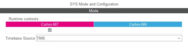

I have used STM32cube to generate the project with below configuration:
Change Timebase to TIM6

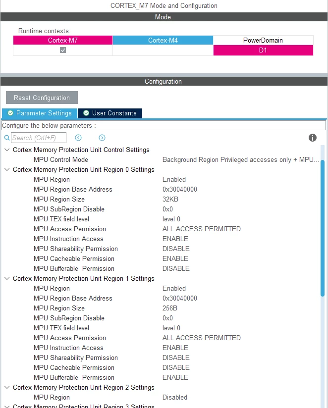

Setup the MPU and enable D and I Cache

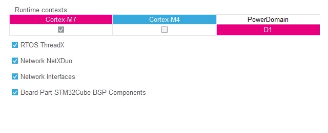

Selected below middleware
