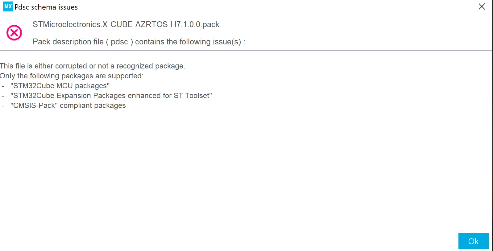

Cannot create a new project with package suggested
Hi, in tried to create a new STM project following the instructions in the slides.
But when I click on finish in the wizard of the project, an error like in scree occurs.
Could you help me?
    1 reply

    Hello @VCico.1​
    I'm not sure what happens here.
    Anyway, could you please download again the materials.
    You should get STMicroelectronics.X-CUBE-AZRTOS-H7.2.0.0 instead of 1.0.0
    And prerequisites slides are should be updated accordingly.
