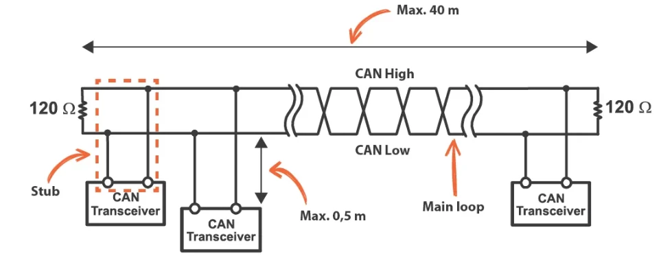

CANBUS communication stops after a while. Is there any solution to make up. (e.g. reset communication)?
Hello everyone. I use STM32F4 to transmit CANBUS messages. When i connect Can High and Can Low lines to CAN-USB transformer i see messages coming to computer but after a short while the communication between MCU and computer stops. If i reset the MCU, message flows restarts but the same problem occurs again.
Has anyone encountered and solved such a problem?
Thanks

Hello. Is it possible to show your code ?

>Has anyone encountered and solved such a problem?<
jepp. do you have termination resitors on both line ends ?
-> if errors -> If the "transmit error counter" is above 255, the CAN interface transitions into this state.

Hello AScha,
I have ended can high and can low terminals with 120Ohm resistor. High and low terminals were connected to can usb tranciever.
So, you mean i must add one more 120Ohm resistor?

0693W00000aJhBTQA0.pngone 120r on each end . check the can/usb adapter to have a resistor - if not, try and add one there also.
