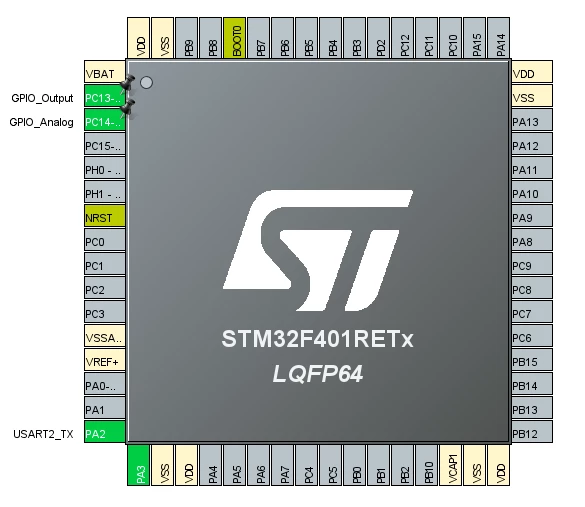

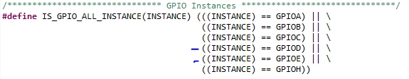

Well, it seems that we can't completely trust IS_GPIO_PIN or IS_GPIO_ALL_INSTANCE; see :
Here is my .ioc for the STM32F401RE project, as you can see there is no E or D port :
but if we check the stm32f401xe.h file where GPIO are defined, we see that PORTS E and D are defined :
and here is IS_GPIO_ALL_INSTANCE macro definition :
Did i miss something ? or does it just suck ?

waclawek.jan
waclawek.janBest answer
Mar 3, 2020 9:31 AM UTC
There are no distinct headers per package, so they inevitably cover the largest package in the given subfamily.
AJT
AJTAuthor
Mar 3, 2020 9:34 AM UTC
Ok, that what i was thinking. Thank you !
