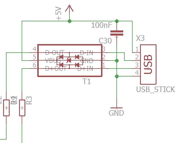

My cutom device, powered by STM32F429ZI, has two USB ports. Each one is connected via USBLC6-2 (ESD protection) chip to MCU (USB FS and USB HS) pins. VBUS is not used.

If I configure both - FS & HS as mass storage devices (host only) then the only one USB stick is initialized (and can be accessed vis FATFS). The second USB stick remains in HOST_IDLE status all the time. I tried swapping sticks and changing USBH instances. Nothing helps.
That's why I am curious if it is possible to run 2 USB ports in mass storage mode. If yes, I am asking you to answer me what I am missing. You could ask me why I needed this configuration. The answer is simple - just a proof of concept. I am just mastering STM32.
Thank you in advance for any answers or hints.
