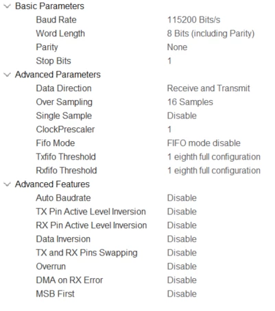

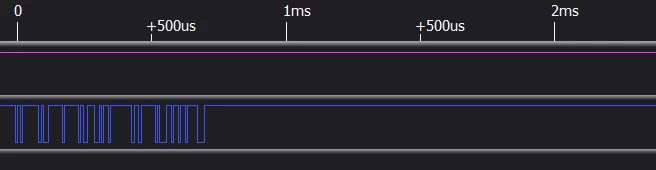

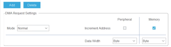

I am trying to use the HAL_UARTEx_ReceiveToIdle_DMA function() but the IDLE function don't work.
I call the function here :
/* Extern variables */
extern UART_HandleTypeDef huart4;
extern osEventFlagsId_t comEventHandle;
extern osMessageQueueId_t sensorQueueHandle;
extern osEventFlagsId_t regEventHandle;
extern DMA_HandleTypeDef hdma_uart4_rx;
static void modbus_receive_DMA(void) {
 buf_rec = 0; // reset the counter of received bytes in the buffer
 /* Reset pin for receiving data */
 HAL_GPIO_WritePin(RS485_SIEMENS_RE_GPIO_Port, RS485_SIEMENS_RE_Pin, GPIO_PIN_RESET);
 if (HAL_UARTEx_ReceiveToIdle_DMA(&huart4, nmbs.msg.buf, sizeof(nmbs.msg.buf)) != HAL_OK) {
 log_debug("HAL_UARTEx_ReceiveToIdle_DMA error");
void HAL_UART_TxCpltCallback(UART_HandleTypeDef *huart) {
 if (huart == &huart4) {
 modbus_receive_DMA();
void HAL_UARTEx_RxEventCallback(UART_HandleTypeDef *huart, uint16_t Size) {
 switch (HAL_UARTEx_GetRxEventType(huart)) {
 case HAL_UART_RXEVENT_IDLE: // when Idle event occurred prior reception has
 // been completed (nb of received data is lower
 // than expected one).
 packet_sended = 0; // clear flag of transmit
 buf_rec = Size; // set size of received data
 nmbs_error res_poll = nmbs_server_poll(&nmbs);
 if (NMBS_ERROR_NONE != res_poll) {
 // This will probably never happen, since we don't return < 0 in our
 // platform funcs
 // If there was no packet transmission, then we immediately switch to
 // receive mode. Otherwise, this function will trigger an interrupt at the
 // end of DMA packet transmission
 if (!packet_sended)
 break;
simon_EQUIUM_0-1739461351484.pngsimon_EQUIUM_1-1739461381278.pngsimon_EQUIUM_2-1739461390277.png
I have tryed to replace sizeof(nmbs.msg.buf) by 1 or 2 or 3 and it works but not in IDLE mode. So the function HAL_UARTEx_RxEventCallback works but not in the right way. I have seen on the forum lot of topics with the same problem but I am not able to fix it with my micro..
Do you have any idea ?

Feb 13, 2025 4:15 PM UTC
Hello TDK,
I have tried to disabled the IT at the half-complete :
__HAL_DMA_DISABLE_IT(&hdma_uart4_rx, DMA_IT_HT);
  but nothing changed
the size of sizeof(nmbs.msg.buf) is 260. I just tested it now with a lenght of 20. Nothing changed.. :
