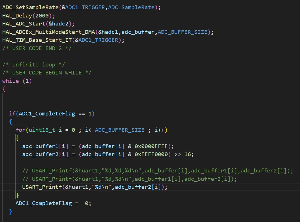

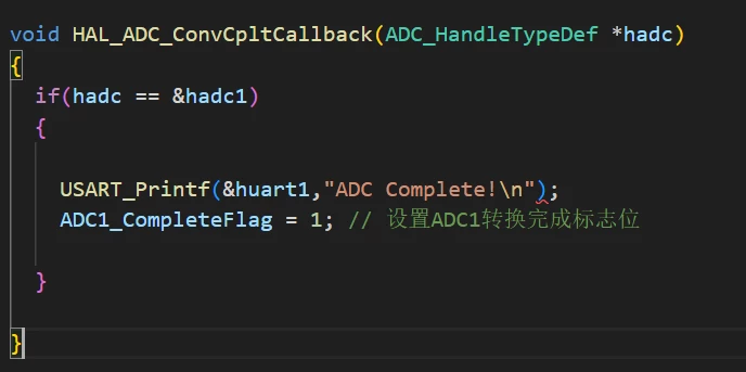

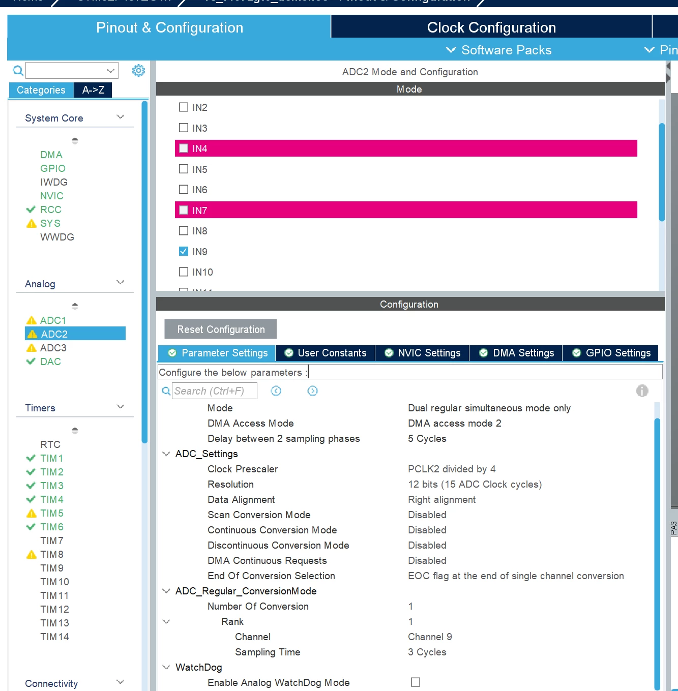

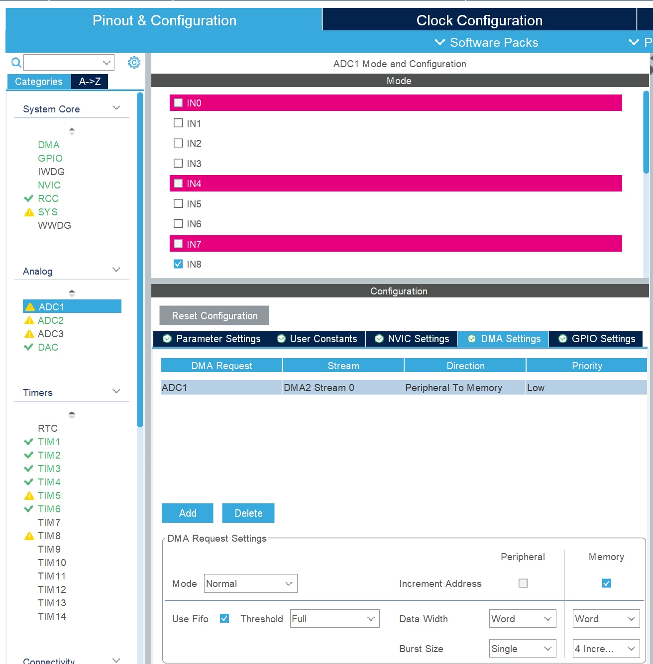

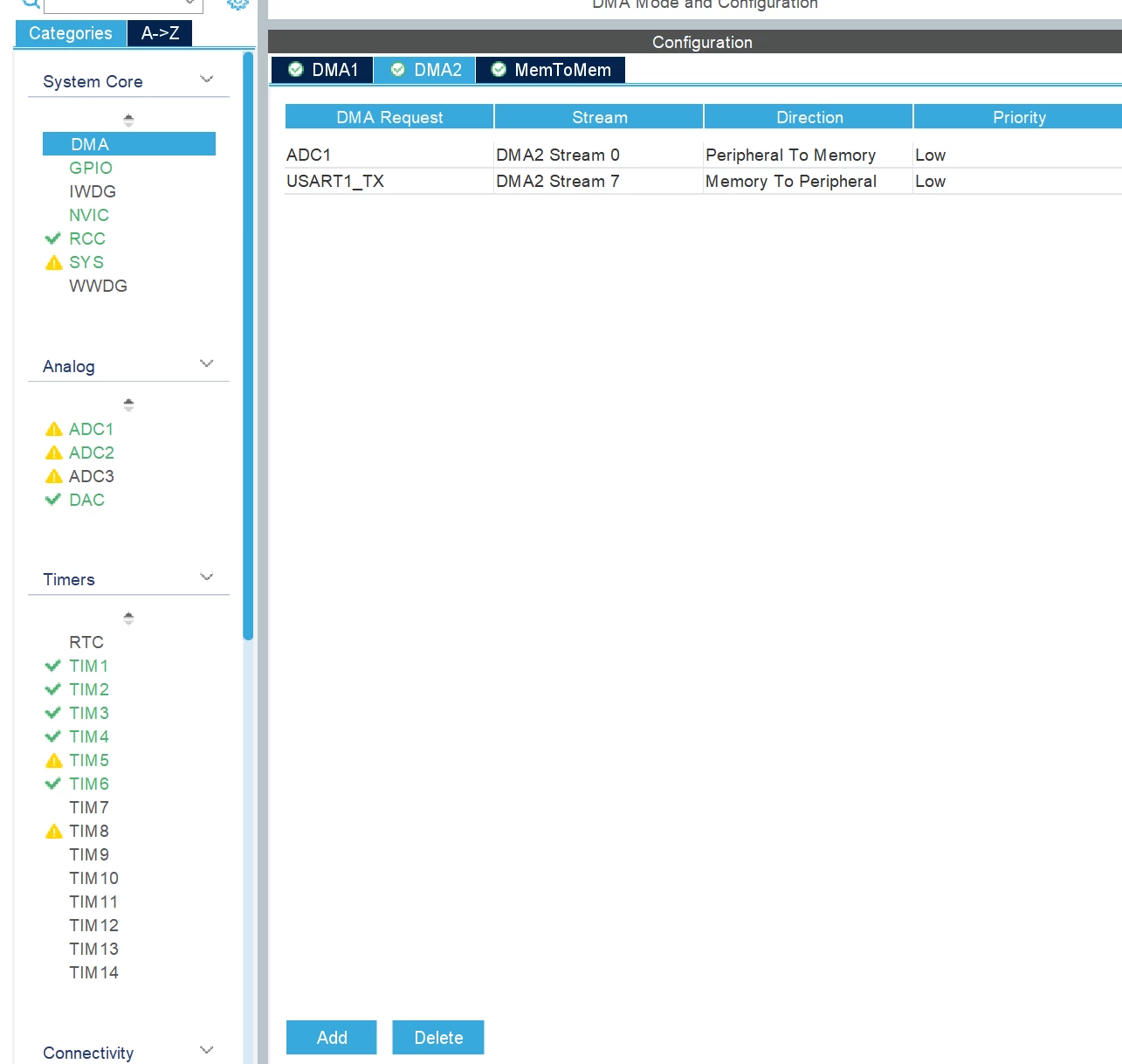

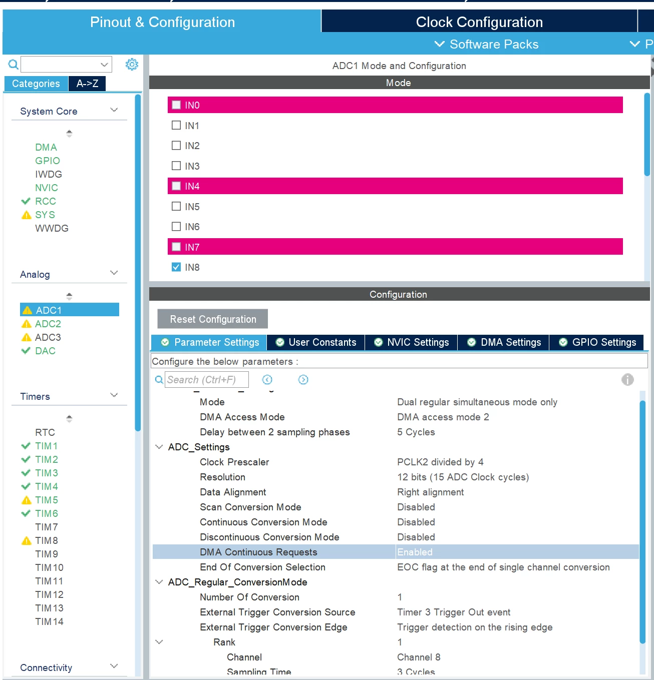

I configured dual DAC synchronous sampling,DMA is in normal mode for data transfer.
When the timer frequency of the ADC is 10KHz, the main cycle can print serial port information, but when the timer frequency is 50KHz, the main cycle does not print ADC data information. What is the reason for this? Below is my cubemx software configuration and related code.

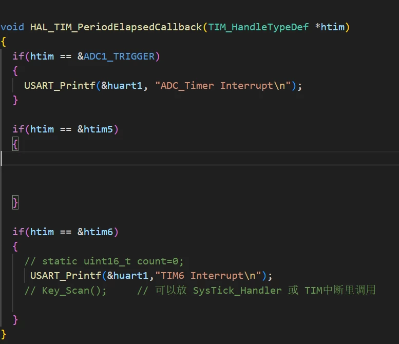

Printing out samples over UART at 50 kHz is a non-starter. The bandwidth is insufficient.
In general, don't put long blocking calls like UART transmissions in your interrupt handlers.

I still don't understand
My DMA works in normal mode and only starts once after powering up, and no more after that. Just set the flag of the ADC sampling in the ADC callback function. Waiting for the ADC to complete the acquisition in the main cycle, and then printing out the data, what does this have to do with the serial port rate?
12 bit ADC data printed in decimal with a line ending takes max 4 digits and 1 line ending character. So 5 characters.
With 1 startbit,1 stop bit, 8 bit data, you need 10 bit times for 1 byte, so 50 bit times per sample. of your UART. 50ks/s would require 2.5MBaud if data is send back to back.That's very high. You can save a little by switching to 7-bit mode, but you still would need 2.25MBaud
Sending it in binary mode would mean each sample will take 2 bytes. If you combine 2 samples you can send 2 samples in 3 bytes with 1.5 bytes per sample. That would require 750KBaud. Much more doable. Using 1MBaud would add some headroom.
In theory you could even do some type of compression. Such as sending the differences between samples and not the absolute value. And then using a variable length int to save space. In that case a sample would take a little over 1 byte on average, and 2 bytes max.
If latency is acceptable you can save samples in a buffer. Convert them and then send them in batches. I would use the DMA for transmitting.

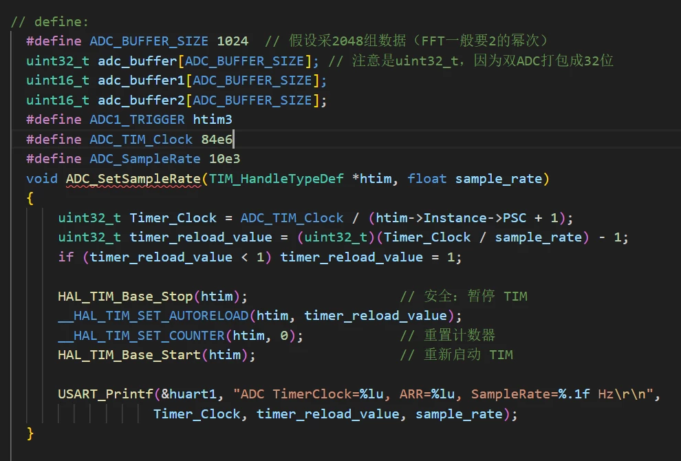

uint32_t adc_buffer[ADC_BUFFER_SIZE]; // 注意是uint32_t,因为双ADC打包成32位
uint16_t adc_buffer1[ADC_BUFFER_SIZE];
uint16_t adc_buffer2[ADC_BUFFER_SIZE];
#define ADC_TIM_Clock 84e6 // 定时器时钟频率
#define ADC1_TRIGGER htim3
#define ADC_BUFFER_SIZE 128 // 假设采2048组数据(FFT一般要2的幂次)
#define ADC_SampleRate 50e3
void ADC_SetSampleRate(TIM_HandleTypeDef *htim, float sample_rate)
 uint32_t Timer_Clock = ADC_TIM_Clock / (htim->Instance->PSC + 1);
 uint32_t timer_reload_value = (uint32_t)(Timer_Clock / sample_rate) - 1;
 if (timer_reload_value < 1) timer_reload_value = 1;
 HAL_TIM_Base_Stop(htim); // 安全:暂停 TIM
 __HAL_TIM_SET_AUTORELOAD(htim, timer_reload_value);
 __HAL_TIM_SET_COUNTER(htim, 0); // 重置计数器
 HAL_TIM_Base_Start(htim); // 重新启动 TIM
 USART_Printf(&huart1, "ADC TimerClock=%lu, ARR=%lu, SampleRate=%.1f Hz\r\n",
 Timer_Clock, timer_reload_value, sample_rate);

 while (1)
 if(ADC1_CompleteFlag == 1)
 for(uint16_t i = 0 ; i< ADC_BUFFER_SIZE ; i++)
 adc_buffer1[i] = (adc_buffer[i] & 0x0000FFFF);
 adc_buffer2[i] = (adc_buffer[i] & 0xFFFF0000) >> 16;
 // USART_Printf(&huart1,"%d,%d,%d\n",adc_buffer[i],adc_buffer1[i],adc_buffer2[i]);
 // USART_Printf(&huart1,"%d,%d\n",adc_buffer1[i],adc_buffer2[i]);
 USART_Printf(&huart1,"%d\n",adc_buffer2[i]);
 ADC1_CompleteFlag = 0;

void HAL_ADC_ConvCpltCallback(ADC_HandleTypeDef *hadc)
 if(hadc == &hadc1)
 USART_Printf(&huart1,"ADC Complete!\n");
 ADC1_CompleteFlag = 1; //
void HAL_ADC_ConvHalfCpltCallback(ADC_HandleTypeDef *hadc)
 if(hadc == &hadc1)
void HAL_TIM_PeriodElapsedCallback(TIM_HandleTypeDef *htim)
 if(htim == &ADC1_TRIGGER)
 USART_Printf(&huart1, "ADC_Timer Interrupt\n");
 if(htim == &htim5)
 if(htim == &htim6)
