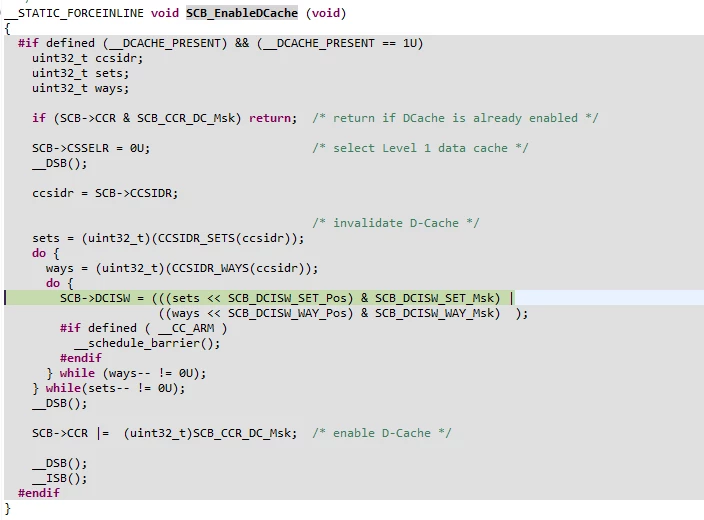

DWill.4
DWill.4Author
Jun 8, 2021 11:48 PM UTC
Debugging is being caught in the Invalidate D-Cache section of code. It only seems to happen when stepping through it.
It is not hard faulting, and there are no errors being thrown when compiling. Both work fine independently but not together.
I'm using the Micron QSPI Nor chip which is memory mapped.
Tesla DeLorean
Guru
Jun 9, 2021 2:20 AM UTC
Ok, so how is the switching between direct and memory mapping handled? Do you arbitrate usage? Does one of the tasks doing writing to this memory?
Reading 4096 bytes into a 50 byte array is going to be a problem.
You should use invalidate with caution, ideally use the "by address" version to limit side effects.

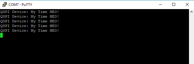

DWill.4
DWill.4AuthorBest answer
Jun 9, 2021 6:05 PM UTC
I figured out that changing my BSP_QSPI configuration to QPI_Mode, and Dual_Transfer resolved the issue.
