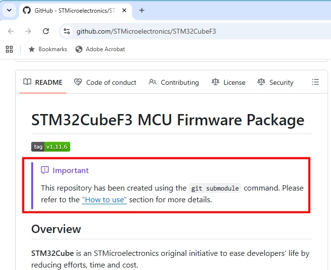

Aug 22, 2026 17:03 UTC
Hello  @Adriano Melis
Please refer to the article below to learn how to download STM32Cube package from github.
Downloading STM32Cube packages from GitHub correct... - STMicroelectronics Community
In order to give better visibility on the answered topics, please click on 'Best answer' on the reply which solved your issue or answered your question. Saket_Om

Adriano Melis
I have downloaded the .zip packages
stm32cubef3.zip
stm32cubef3-v1-11-6.zip
and unpacked them (the second over the first)
Please suggest the steps needed to import the example ...STM32Cube_FW_F3_V1.11.0ProjectsSTM32F3-DiscoveryExamplesBSP
in STM32CUbeIDE,
I would like to build and run it (I have the STM32F3DISCOvery board)
to understand how to use from another MCU the sensors onboard.

EXUE.2
Hi Adriano,
it is sure to miss some files if you clone it or download zip directly from the github, please use command 'git clone --recursive https://github.com/STMicroelectronics/STM32CubeF3.git' to clone it, you will get the complete project which can work well.
Adriano Melis
Aug 22, 2026 17:09 UTC
Done, thanks.
Maybe the role of the checkboxes in figure 3 should be emphasized, explaining their purpose:
- Search for nested project
- Detect and configure project natures - this one, if  unchecked, prevents the correct importing of the ac6 project (the import remains incomplete)
mƎALLEm
Aug 27, 2026 08:43 UTC
I suppose you cloned the github link without the recursive option.
Please refer to this article: Downloading STM32Cube packages from GitHub correctly
