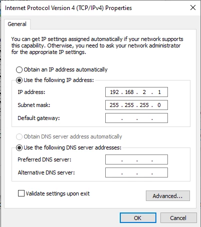

Essentially, I can’t get a ping out of either Nucleo-H755ZI-Q or STM32F779I-EVAL, the other thread focuses on the Eval board.
I’ve tried many examples but I’m focusing on this one. There are other threads about this example but I think they may have got lost in the migration.
I’ve attached the project as it sits on my computer.
The STM32 device’s IP address is 192.168.2.180.
If I ping it on my PC, I get Request timed out.
This is my network configuration.
The Nucleo board is connected to a TP-Link Ethernet switch, which my PC is also connected to.
Do you have any idea why this is not working?
Thank you.
