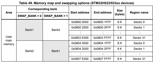

Testing is done with the Nulceo-U545RE-Q board having 512KB Flash organized in two Banks. Each Bank has 32 pages of 8KB each. Flash Bank1: 0-31 pages. Flash Bank2: 32-63 pages.
I could switch-over from Firmware-Version1 executing in Bank1 to Firmware-Version2 executing in Bank2.
I verified that Firmware-Version2 was executing correctly even after hardware reset and power cycle.
Attempting to switch-over  from Firmware-Version2 executing in Bank2 to Firmware-Version3 executing in Bank1 fails as I end up erasing the Bank with the currently executing software(Firmware-Version2).
I checked the setting of the SWAP_BANK bit and then erased the Bank, using the code below:

Using CUBEPROGRAMMER, I verified that the SWAP_BANK bit is set (checked).
Using CUBEPROGRAMMER, I noticed that Bank1 has been Erased! This had Firmware-Version2.
Now assuming that with the SWAP_BANK bit as set, Bank2 with Firmware_Version2 is now mapped as Bank1. And so Bank1 with Firmware_Version1 is now mapped as Bank2.

Final got to work on this again after nearly a year. It works now. Updating from Bank1(version1)->Bank2(version2)->Bank1(version3)->Bank2(version4)->Bank1(version5)… There may have been some logical errors in my earlier code.
Thanks to ​@rulin  and ​@FBL for support across multiple related discussion topics.
Working code is as below.

Note the addresses of Bank1,2 as per the Swap_Bank option bit, referring the STM32H5 Reference Manual RM0481
