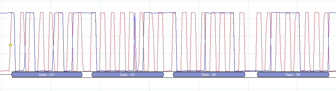

I am calling BL_Init a moment after I am sure the slave uC has entered the BL. Is there specific timing to adhere to? I am not using any other periphery to connect to the BL. I can see that the bootloader sends a dummy while the master sends the sync byte. However after that the master loops in wait_for_ack() because the bootloader just sends garbage data while the master sends dummies
FLewz.1
FLewz.1Author
Jun 27, 2022 7:33 AM UTC
This is a scope snippet of the MISO line for BL_INIT. You can see when the master sends the sync byte the slave still sends its dummy byte A5. After that, when the master sends dummy bytes, the slave bootloader just sends garbage data, instead of ACK. ACK would be 0x790693W00000NsmxzQAB.png

FLewz.1AuthorBest answer
Jun 27, 2022 8:58 AM UTC
To anyone who might face the same issue:
I was under the impression, all interrupts need to be disabled before entering the ROM bootloader. This is mentioned in AN2606
In addition to patterns described above, user can execute bootloader by performing a jump to system memory from user code. Before jumping to bootloader user must:
• Disable all peripheral clocks
• Disable used PLL
• Disable interrupts
• Clear pending interrupts
However disabling interrupts and relocating the vector table seems to have caused the issue.
This was what my function to enter BL now looks like without disabling irqs and leaving the vector table at application entry:
