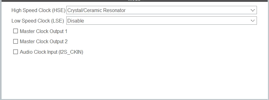

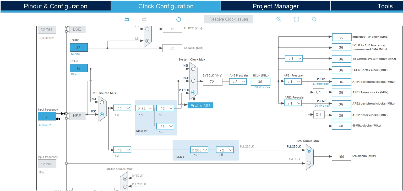

I see that my code hanging at  SystemClock_Config(); So i changed the settings according to the images below
But the same issue still occurred

So you've configured it to use an external crystal.
Does your Discovery board actually have an external crystal?

  1. The clock configuration function SystemClock_Config() hangs if I select the external crystal (HSE).
    > FBL_0-1755099987782.pngmake sure your HW setup is properly configured: Check SB14, SB16 OFF  –  R25 ON – R66 OFF
  2. The project only blinks the LED successfully when I disable USB_OTG_FS and switch to the internal oscillator (HSI). When USB_OTG_FS is enabled, I cannot select HSI as the PLL input because the MX requires HSE for USB. Disabling USB_OTG_FS allows me to select HSI and blink the LED.
    > I would recommend to describe your goal then your issue. Do you want to develop USB Host application using this F411 disco board? Did you test this example STM32CubeF4/Projects/STM32F412G-Discovery/Applications/USB_Host/HID_Standalone at master · STMicroelectronics/STM32CubeF4
    USB OTG full-speed controller requires a dedicated 48 MHz clock that is generated by a PLL connected to the HSE oscillator as it is mentioned in datasheet section 3.27
