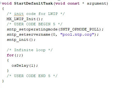

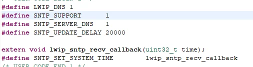

Can't access NTP server with a static IP address
Hi all.
Now i am using STM32h747 for get time from NTP server
0693W00000aJb8TQAS.png0693W00000aJb8YQAS.pngIt working well with DHCP config, But when I config Static IP and can't access NTP server
can anyone help me with this. Thanks

Bob S
Mar 24, 2023 3:48 PM UTC
When using DHCP, what are the IP address, netmask and default gateway that you get? And when you use static IP, what IP address, netmask and gateway are you setting?
