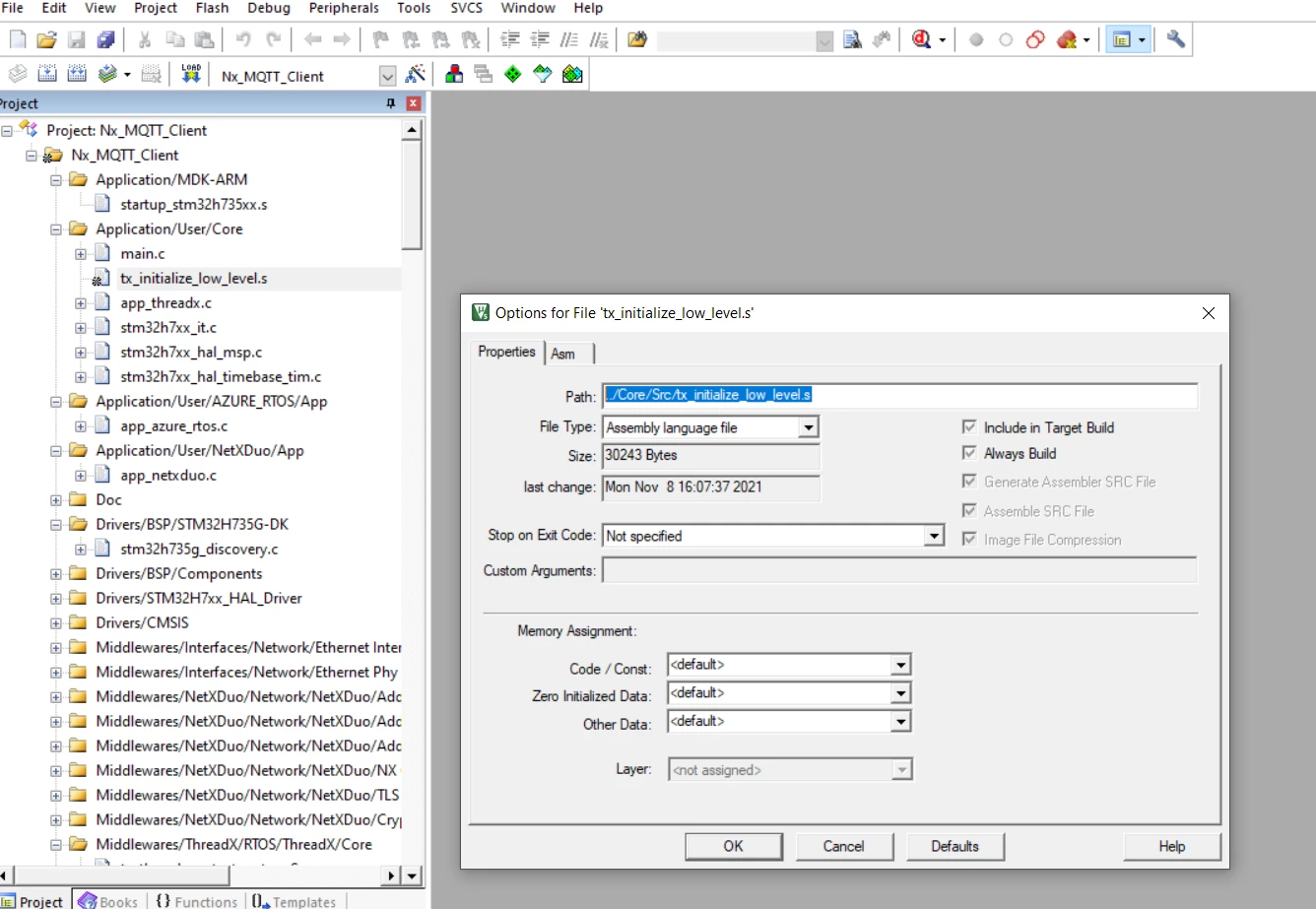

Can someone try to compile Azure RTOS MQTT for the H735DK ?
I keep getting the same errors:
trying to compile a fresh copy from GITHUB
Repository\x-cube-azrtos-h7-main\Projects\STM32H735G-DK\Applications\NetXDuo\Nx_MQTT_Client
Surely someone at ST can compile this code and tell me what is missing...

Mike_ST
February 4, 2022
>> Can you compile it please ??
I just compiled it under IAR 9.20.1 and STM32CubeIde 1.8.0 and I get no error (I don't have Keil on my PC)
>> When you find out how to fix it, can let me know ?
From the errors in the screenshot, it seems like you don't compile the files:
Middlewares\ThreadX\RTOS\ThreadX\Core\tx_thread_schedule.s
Application\User\Core\tx_initialize_low_level.s
Middlewares\ThreadX\RTOS\ThreadX\Core\tx_thread_stack_build.s
And maybe other assembly files.
Hope that helps a bit.

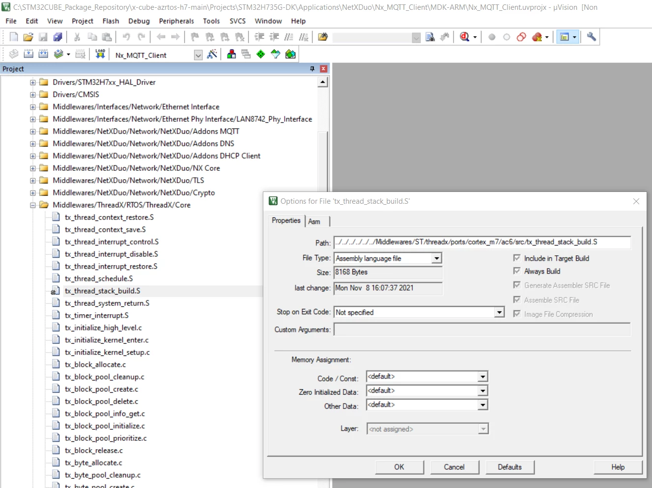

Mike_ST
February 7, 2022
Hello again,
>> there is no folder RTOS under Threadx there is no Core under Threadx
Sorry for the incorrect paths, I blindly copied them from the IAR map file... But they are not the actual ones:
so for IAR tx_thread_schedule.s and tx_thread_stack_build.s are in:
\Middlewares\ST\threadx\ports\cortex_m7\iar\src
But I think you guessed it already.
>> there seems to be a batch file for compiling this stuff... can you ask the CubeMx team to fix this issue... for the MDK-ARM solution ?
Keil uses the files in \Middlewares\ST\threadx\ports\cortex_m7\ac6 folder (please check screenshot if that helps).
T J
T JAuthor
Senior III
February 8, 2022
@Mike_ST​
Hi Mike,
thanks for the support...
ok, I had to copy the /ac5/example_build folder over to ac6
so I could add the initialise_low file..
and like you said, the
... Repository\x-cube-azrtos-h7-main\Middlewares\ST\threadx\ports\cortex_m7\ac6\src\tx_thread_stack_build.s and tx_thread_schedule.s
I checked the ... Repository\x-cube-azrtos-h7-main\Middlewares\ST\threadx\ports\cortex_m7\ac6\inc file was already included in the linker folder list
but now there are huge numbers of errors...
nope wont compile...
build log attached
Can you check the MDK-ARM build ?
on a fresh Windows install ?

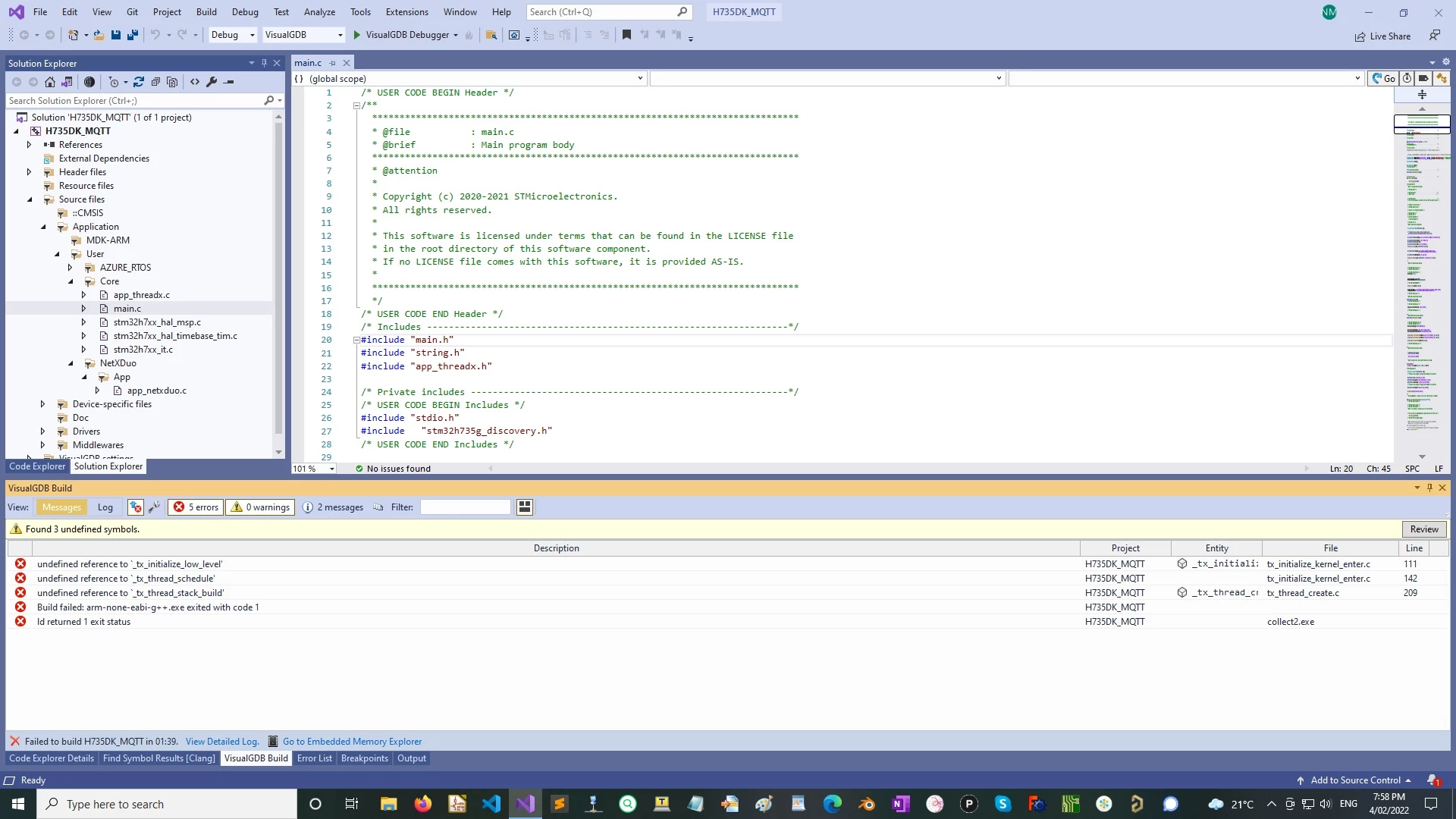

Mike_ST
February 8, 2022
from the log pictures, I would say that you're trying to compile the wrong tx_initialize_low_level.s
Please use the one in the project folder:
x-cube-azrtos-h7-main\Projects\STM32H735G-DK\Applications\NetXDuo\Nx_MQTT_Client\Core
T J
T JAuthor
Senior III
February 10, 2022
Hi Mike, @Mike_ST​
Yes, that low level init was ftom the AC6 folder I had to copy from the AC5 folder...
ok, switching to the new file ..
ok, thats much better , but still has a few issues,
now linking these 3 extra files to the cube project..
......Repository\x-cube-azrtos-h7-main\Projects\STM32H735G-DK\Applications\NetXDuo\Nx_MQTT_Client\Core\Src\tx_initialize_low_level.s
checking the other files: // please check these are correct...
......Repository\x-cube-azrtos-h7-main\Middlewares\ST\threadx\ports\cortex_m7\ac6\src\tx_thread_schedule.s
.....Repository\x-cube-azrtos-h7-main\Middlewares\ST\threadx\ports\cortex_m7\ac6\src\tx_thread_stack_build.s
ok, the new error list is tiny...
DTCRAM is overflowing ?
plus a couple extra issues, please revert back...
Thanks for the good work... almost there...
@Alexander CZAJOR​ looking good but not quite there... it seems that the cube team haven't added all the files to the script on MDK-ARM project.
I import the MDK-ARM project into Visual Studio....
Mike_ST
February 10, 2022
_tx_timer_interrupt is defined in tx_timer_interrupt.s
Do you compile it .?
__Vectors is defined in startup_stm32h735xx.s do you compile it ?
Not sure, Symbol Image$$RW_IRAM1$$ZI$$Limit seems to refer to
the following section in the scater file Nx_MQTT_Client.sct:
 RW_IRAM1 0x24000000 0x00030000 {
  .ANY (+RW +ZI)
Maybe you have to adapt it for the IDE you are using.
Don't know what you are talking about as that project compiles without error under MDK-ARM.
Haithem Rahmani
February 9, 2022
Hi @Community member​,
Which MD-ARM version are you using? it should be v5.31 or higher.
Just tested and the project compiles correctly with some known warnings nothing more.

T J
T JAuthor
Senior III
February 16, 2022
Sorry guys I cant get it to work on Visual Studio.
I dont want to use any other platform..
If you could get it working and let me know the secret...
Obviously something is different.
I have to dump ST, if its unsupported in Visual Studio....
I dont have MDK-ARM, I just use the Cube MDK-ARM link, to import into Visual Studio...
everything else is a breeze in Visual Studio
Azure shouldn't be so hard.
@Alexander CZAJOR​  can you ask someone to work on the Visual Studio compile ?
