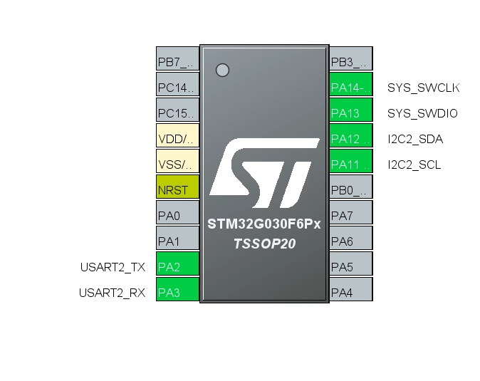

I recently created a custom board based on STM32G030 IC and programmed it via UART to run my application. Now, I want to make some changes to my firmware, but I can not connect to the CubeProgrammer. I have tried connecting it via UART and ST-LINK. Below are the errors i get when I try to connect the board via different methods
via UART- "Error: Activating device: KO. Please, verify the boot mode configuration and check the serial port configuration. Reset your device then try again... "
via ST-Link- "Error: No STM32 target found! If your product embeds Debug Authentication, please perform a discovery using Debug Authentication". The interesting thing here is that CubeProgrammer reads the board as a Nucleo-F303RE(I am using the ST-LINK from this board and have removed the necessary jumpers i.e on CN2)
I have tried to give 3.3V to pin 19(PA14) of the IC which is the Boot0 pin and restarting the board, but I am still not able to program the board. I can confirm that the IC is running the firmware which I uploaded as I can view it on one of my COM ports. How do I get the board back into programming mode? Even the SWD debugging is not working

Ok.
> I would like to reprogram the board using UART
Then you have to use the Boot pin , PA14/15 ; + pulldown (10k) ; + 100nF cap on NRST .
+ set nBOOT_SEL bit -> 0 (with swd connection -> option bytes )
Then (after reset, with boot pin PA14 : high ) you get bootloader access on Rx/Tx .
So you need : nrst, swd, swc, boot pin, and Rx, Tx ; 6 pins for this !
If you just use st-link , swd, then : nrst, swd, swc ; 3 pins .
And you can even the swd+swc pins use for other function, if dont need debug any more;
still have access to swd with hard-reset/under reset , to flash/program/set option bytes .

how you tried to connect ? (try: software reset )
show pic, what programmer shows ...

I have tried to connect with the SWD pins via Normal mode and the hotplug mode but to no avail. I have tried both Hardware Reset and Software reset. I do not have the picture today, but I'll attach the pictures from the programmer tomorrow.

just , for hard reset: is the NRST connected to the G030 ? + check its working , with scope ?
What about the Boot pin , PA14/15 ? What you set in option bytes ?
-> Maybe only way to connect with st-link "under reset" , (hardware reset) .
