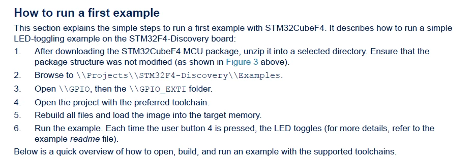

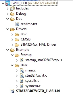

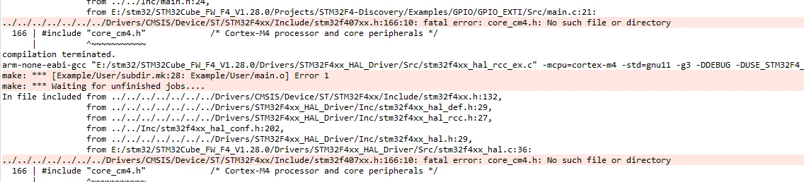

I just download STM32Cube_FW_F4_V1.28.0 and using Cube IDE 1.18 run first example follow Documentation in STM32CubeF4GettingStarted.pdf  attach.
But it can not Build / Run Correctly.

Are you downloading STM32Cube packages from GitHub? if yes, please look at this FAQ to avoid the compilation errors.
Alternatively, you can download our packages directly from ST.com by using the link below:
https://www.st.com/en/embedded-software/stm32cube-mcu-mpu-packages/products.html.

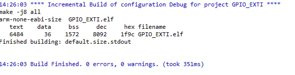

I'm not able to reproduce your issue. For my side the GPIO_EXTI is built without error.
May this post can help you to solve the "fatal error: core_cm4.h: No such file or directory" error.

I run it in Tab Example Selector on CubeIDE with Discovery Board Completely. Its OK. Thanks for your help!
