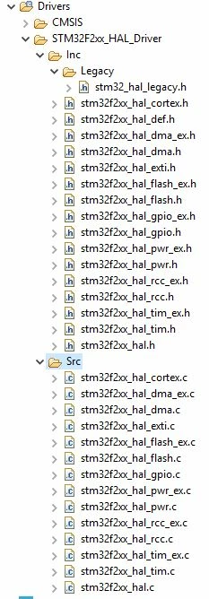

MAesc.1
Jan 31, 2020 3:08 PM UTC
I have the same issu for a F2. In the MCU Package Version 1.8.0 for the STM32F2 it is mentioned, that the old CAN driver is still available. But as you can see in the image, there is no one. And a definition of "HAL_CAN_LEGACY_MODULE_ENABLED" leads to an "Unresolve inclusion error". Is there a workaround? Our customer is running tests for 2 months with the olc CAN API and it is crucial not to repeat these tests with a new CAN API.
christophkeiner9
Feb 3, 2020 11:16 AM UTC
Yes, i know, there are a lot of little things to do to get it run, therefore i would not rely on a new software with so many little manual changes.
I would turn back to the older Cube-Version or use the new CAN Driver and do the testing again.
