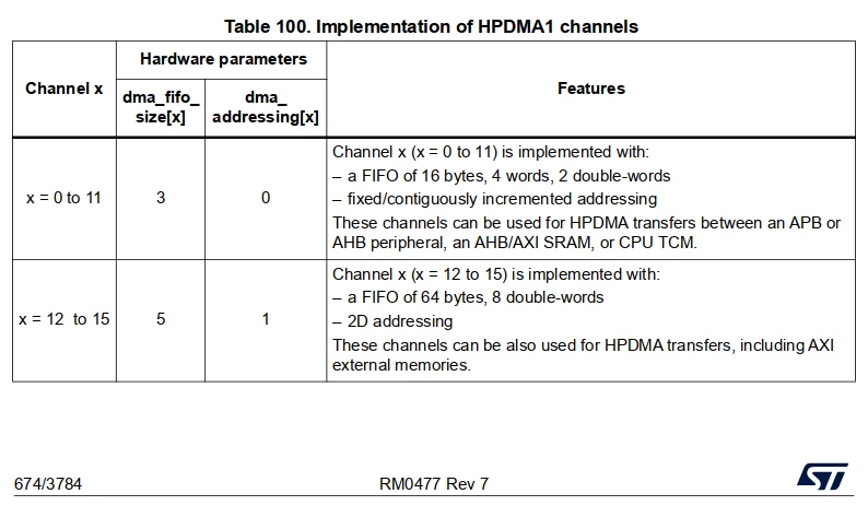

I'm trying out both the DMAs on the STM32H7S3L8. I am trying to keep it as simple as possible, so I am not using linked list mode (I think. CxLLR is 0). When using HPDMA, I get a Data Transfer Error when trying to copy from SRAM1 to DTCM. The datasheet says the following:
Specifically, note that it seems to suggest it is possible for HPDMA to access CPU TCM, which I assume to be/include DTCM.

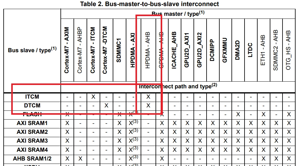

To answer your question "Can HPDMA on the the STM32H7S3L8 access DTCM memory?"
The answer is yes according to the product reference manual:

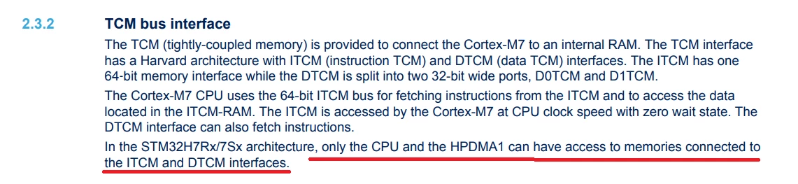

And from the AN6062:
chintalAuthor
Dec 10, 2024 5:46 PM UTC
Thank you!
I was trying to use the AXI port, which was the problem. Using the AHB port resolved the issue.
