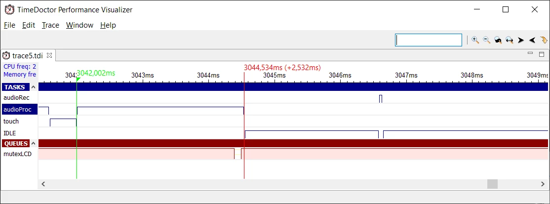

KnarfB
Oct 26, 2021 9:13 PM UTC
Here is a TimeDoctor trace of a FreeRTOS project with 4 scheduled tasks:0693W00000FDq3DQAT.pngfor TimeDoctor see https://gitlab.com/KnarfB/timedoctor (work in progress)
