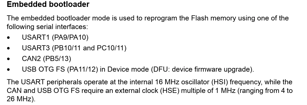

Hi ST team,
I'm trying to upload a new code to the STM32F103 via CAN tx/rx. I set the device to boot mode, BOOT0 = 1 and BOOT1=0 (system memory).
I sent a CAN frame via CAN tx/rx, but I didn't get any response from the STM32 CAN bootloader.
Is it possible to do this?
Is there a CAN bootloader in STM32F103RBT6?
If not, please suggest me any other model of STM32 for this project.

if you would look in the RM , you would see:
0693W00000Y7dVmQAJ.pngIs no CAN bootloader in STM32F103RBT6.
stm32F407 has:

could you please show me the way of uploading a new code to STM32F407 via the CAN port?
It will be much helpful if you can provide me detailed process.

no, i never boot on CAN , only USB .
maybe read here > CANFd. Reference was taken from "AN5405"
https://community.st.com/s/question/0D53W000022xmqCSAQ/stm32g0b1cbt6-system-bootloader-canfd-no-response
