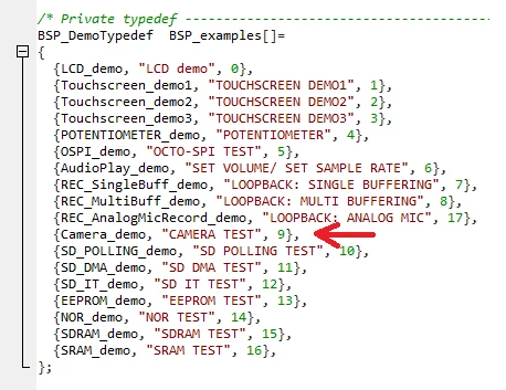

  • I am using the STM32H7B3I-EVAL board. I checked STM32CubeH7.
Since the board supports camera (DCMI) .
  1. Any camera demo project for testing LCD preview
  2. Availability of prebuilt binaries (.hex / .bin / .elf) for quick hardware testing
Goal: quick validation of camera
Please share any working example or reference.

Use BSP example in the CubeHAL to test the camera:
https://github.com/STMicroelectronics/STM32CubeH7/tree/master/Projects/STM32H7B3I-EVAL/Examples/BSP
And use "Camera test" demo.
Hope that helps.
