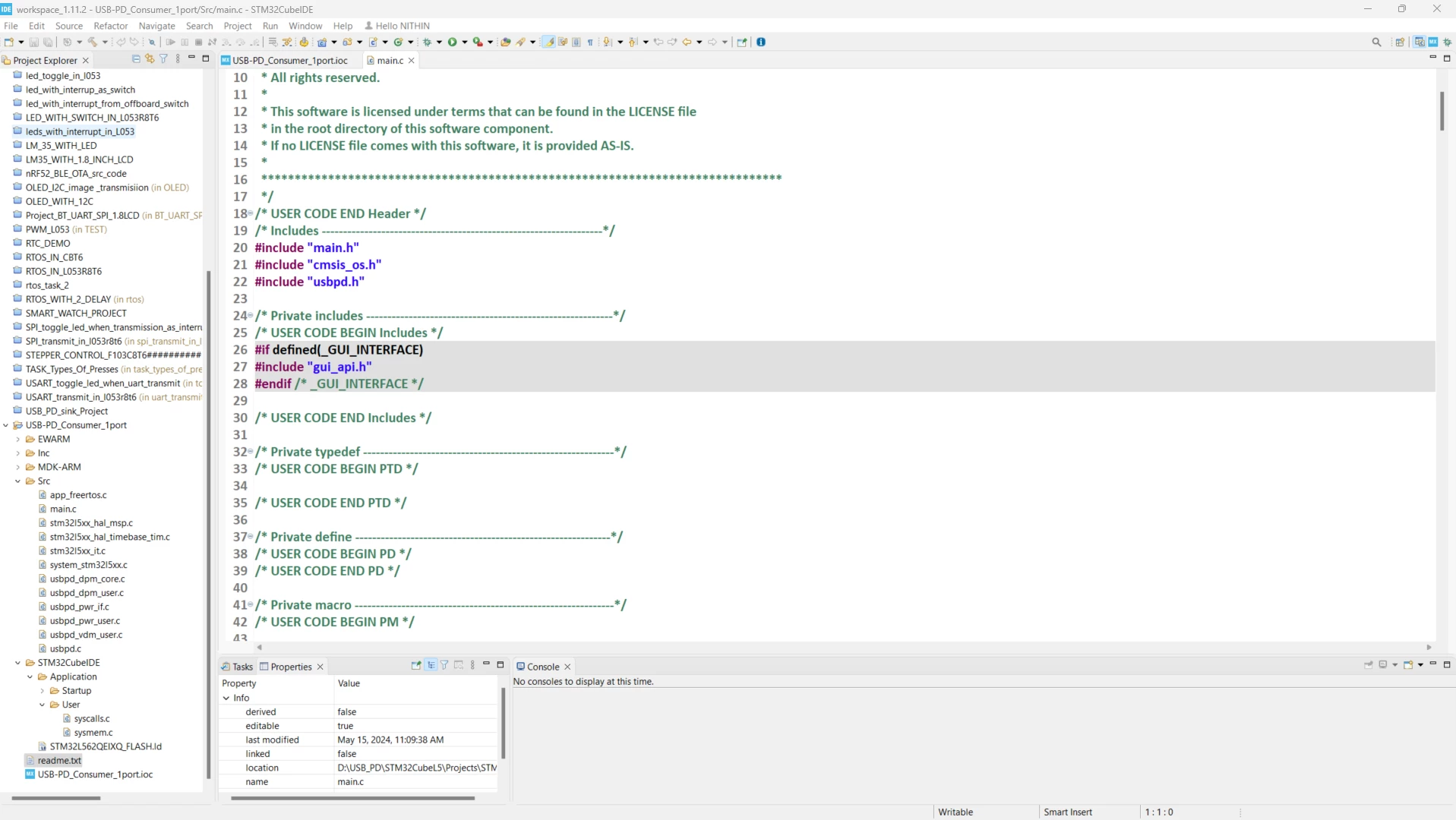

May 15, 2024 7:33 AM UTC

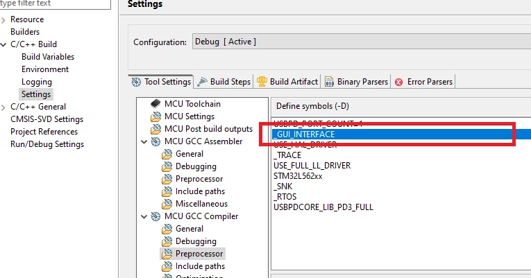

mƎALLEm
May 15, 2024 1:14 PM UTC
That's strange.
If you go to the Preprocessor menu, you need to find the flag _GUI_INTERFACE:
I've cloned the project and the define is there.. could you please check in your Preprocessor config?
Peter BENSCH
May 15, 2024 10:13 AM UTC
You have cloned a project from the repository that has many internal references to library functions within the STM32L5 firmware package. If you download the whole STM32L5 firmware package (via Github or here) and import the project directly from it, you should be able to compile.
Hope that helps?
Regards
/Peter

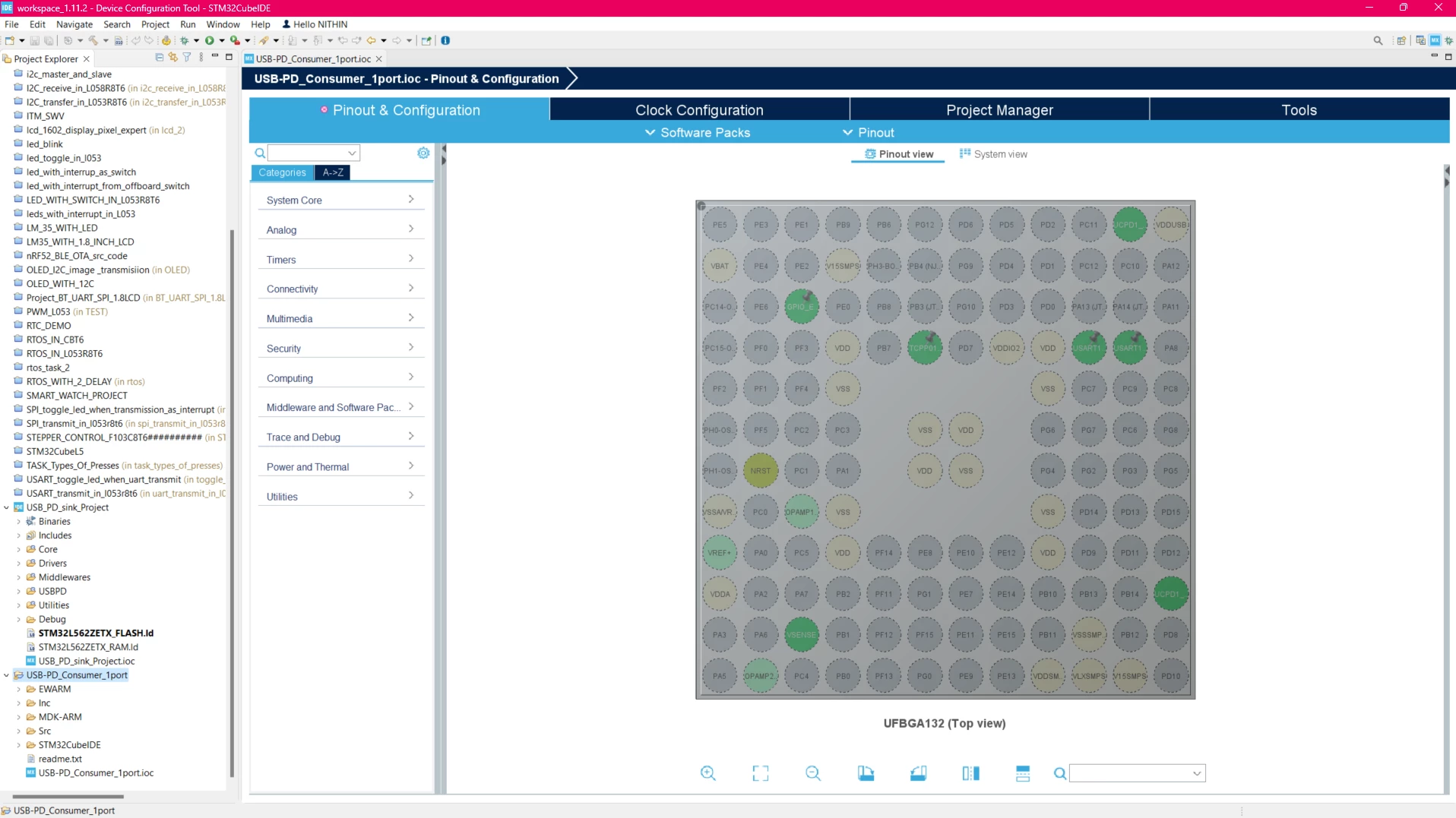

NITHINAuthor
May 17, 2024 5:23 AM UTC
Hi @Nicolas P. , @Peter BENSCH , @mƎALLEm ,
I've cloned this repository using recursive option and i directly imported the project file "USB-PD_Consumer_1port" only , from "D:\USB_PD\project_1\STM32CubeL5\Projects\STM32L562E-DK\Applications\USB-PD\USB-PD_Consumer_1port"
but i can't build the project ,as the build option is disabled, but I'm able to build other  projects in my ide.
other projects are opening as stm32 project and this one is opening as just a file system, is that the reason?

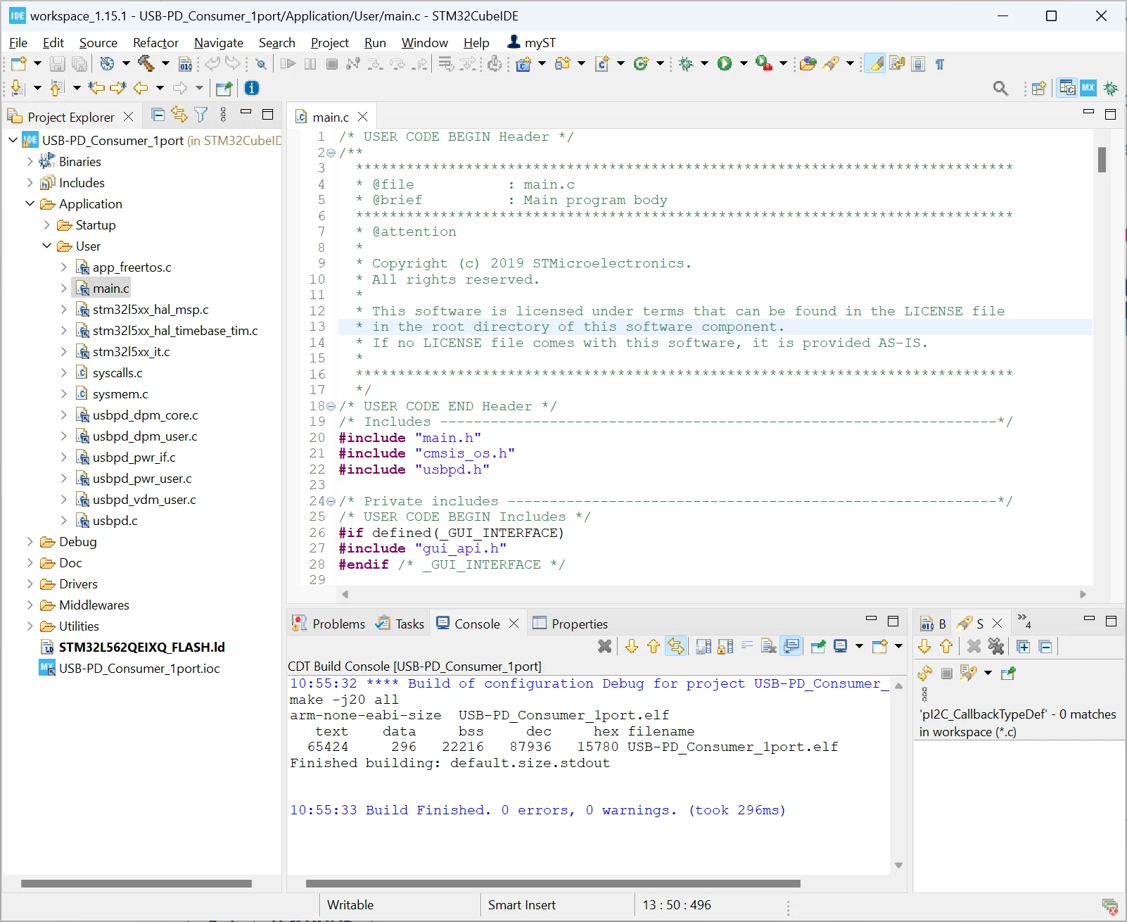

Nicolas P.
May 17, 2024 8:16 AM UTC
Hello @NITHIN
From the picture it seems you opened the .ioc file. Am I right ?
We wouldn't see the EWARM, MDK-ARM directories because useless when using CubeIDE.
I'm using CubeIDE 1.15.1, and opening the file : STM32CubeL5\Projects\STM32L562E-DK\Applications\USB-PD\USB-PD_Consumer_1port\STM32CubeIDE\.cproject opens the project without issue.
I have no issue compiling too.
Regards,
Nicolas
NITHINAuthor
May 17, 2024 9:43 AM UTC
Hi @unsigned_char_array  and @Nicolas P. ,
thank you for your guidance....
all the problems are solved and the program built perfectly
Thank you
