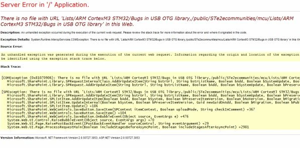

P.S. Some issues with the new forums as well.
