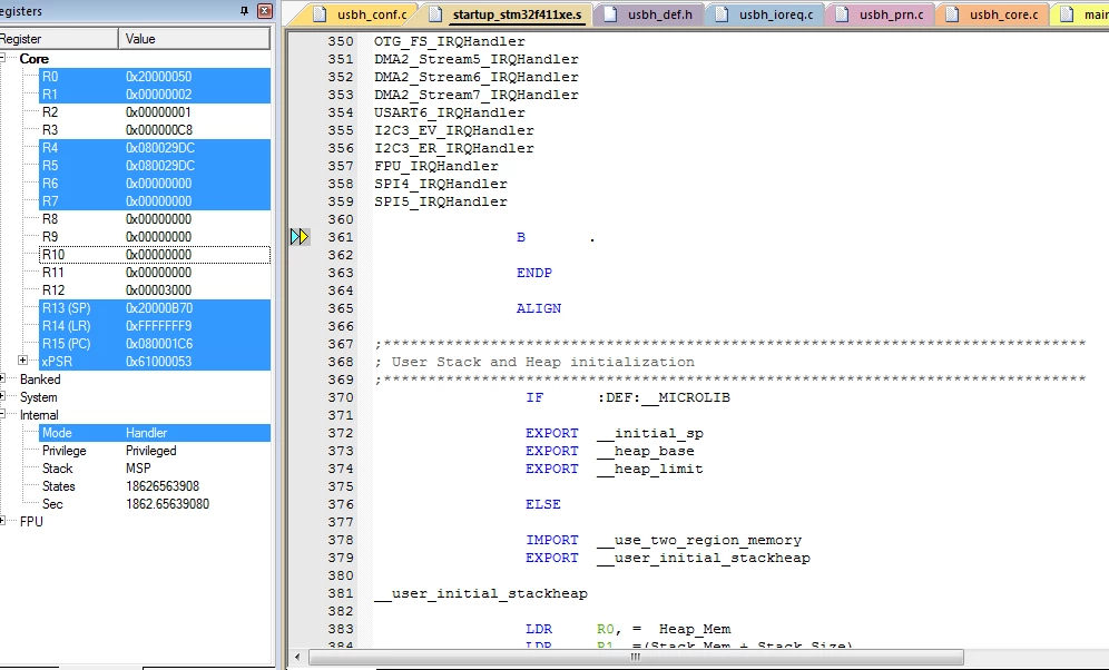

I'm facing trouble when I try to connect a USB device (whatever it is) to my
http://www.st.com/web/en/catalog/tools/PF260320
. As I plug it, my program is stuck here : 0690X00000605NYQAY.png Here is a little connection diagram : 0690X00000605NdQAI.png The LP2980 is a linear regulator. Its ground is connected with the ST's one. The ST32 is powered by the micro-usb (U5V so). This is how I configure my GPIOs into usb_conf.c :
GPIO_InitStruct.Pin = (GPIO_PIN_11 | GPIO_PIN_12);
GPIO_InitStruct.Speed = GPIO_SPEED_HIGH;
GPIO_InitStruct.Alternate = GPIO_AF10_OTG_FS;
HAL_GPIO_Init(GPIOA, &GPIO_InitStruct);
GPIO_InitStruct.Pin = GPIO_PIN_6;
Then I set PA6 to have 3.3V. Has Anyone a idea about this ? #usb #stm32f411re
Looks like an exception handler gets called that has just a default implementation and that default implementation is just an endless loop.

Thanks,
Indeed I forgot to add OTG_FS_IRQHandler in stm32f4xx_it.c. Now I'm facing another problem when I plug it. When I do that, the programm stops running and get stuck somewhere in the dissassembly code.
0x08003068 BEAB           BKPT                          0xAB
When I look into the .map file I've got :
fputc     0x0800305d   Thumb code     18   fputc.o
free       0x08003071   Thumb code     75   malloc.o
I precise that I'm using Keil and I began with the Hal_TimeBase (from STM32F411RE-Nucleo) example and be inspired by the MSC_Standalone (from STM324xG_EVAL) to make my project.
I didn't find yet what could be wrong.

You have some printf() but lack any retargeting code that associates that with some output method or USART on your board?

Hi clive1,
You point out the right thing. I delete the usb's debug messages which use printf() and now my program run.
Still I cannot detect my device but this is another story and I can debug correctly now.
