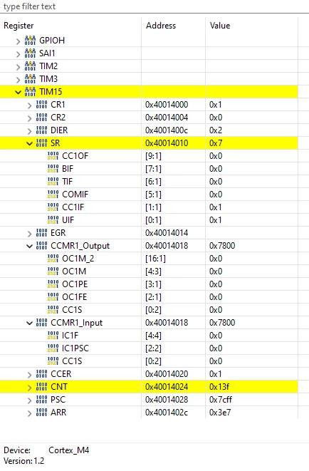

Bug: TIM15 CH2 missing in debug / STM32L4x2.svd
According to RM0394 Rev 4, TIM15 has 2 channels, but only the first is present in the .svd file and hence the debug view, see attached picture.
Observed for STM32L432KC using STM32CubeIDE 1.9.0, (com.st.stm32cube.ide.mcu.productdb.debug_2.0.200.202201061234)
hth

Hi @KnarfB​ ,
Thanks for bringing this issue to our attention.
I reported it to the team taking care of svd files maintenance.
Internal ticket number: 124720 (PS: This is an internal tracking number and is not accessible or usable by customers)
