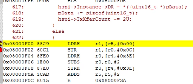

I have found a bug in the STM32F0xx HAL SPI driver, specifically in the HAL_SPI_Transmit andHAL_SPI_TransmitReceive functions. Basically they are converting a pointer to uint8_t into a pointer to uint16_t. The problem with that is that the M0 cannot support unaligned accesses and the uint8_t pointer is not guaranteed to be on a 16 bit boundary. In fact this has happened to me and the software hard faults when the conversion is attempted.

Posted on February 22, 2017 at 21:59
I just ran into this exact same problem. When the data pointer is odd the SPI handler crashes, works OK on even bytes.
Here's the offending instruction highlighted in yellow:
When r5 is odd execution ends up in the Hard Fault Handler as reported above.
I'm using STM32Cube FW_F0 V1.7.0  with STMCube v4.19.
This bug was reported last September. Is there yet a fix or work around for it?

This issue is confirmed and will be fixed in the next release of STM32CubeF0.

If I remember correctly it is only the blocking function that has this problem.  If you use one of the non-blocking functions (either interrupt or DMA) it should work.
The only other thing to do (until this is fixed) would be to declare your data as 16 bit and then cast it to 8 bit where you need to.
uint16_t array16[4];
uint8_t *array8 = (uint8_t *)array16;
array8[0] = 1;
array8[1] = 2;
While highly undesirable this would guarantee that the array is always created on a 16 bit boundary.
Sidlauskas.David
February 23, 2017
Posted on February 23, 2017 at 18:29
Thanks for the info.
I used the __align(2) compiler directive to put the data on a 2 byte boundary.

In the last release of CubeF0 v1.8.0, the issue fix consist of adding an assert in case the input param pData address is not 16-bit aligned:
HAL_StatusTypeDef HAL_SPI_Transmit(SPI_HandleTypeDef *hspi, uint8_t *pData, uint16_t Size, uint32_t Timeout)
uint32_t tickstart = 0U,
HAL_StatusTypeDef errorcode = HAL_OK,
if ((hspi->,Init.DataSize >, SPI_DATASIZE_8BIT) || (Size >, 1U))
/* in this case, 16-bit access is performed on Data
So, check Data is 16-bit aligned address */
assert_param(IS_SPI_16BIT_ALIGNED_ADDRESS(pData)),
The fix triggers an assert if the input param pData address is not well aligned =>, on M0 core, it is up to the user to ensure pData address is 16-bit aligned.
NOTE: if the user enables USE_FULL_ASSERT, then, assert_param will trigger a fault that inform the user that something is not well configured (user file stm32f0xx_hal_conf.h).
To avoid the reported issue, user must use pre-compilator option to align Rx/Tx buffer on 16bit/32bit.
