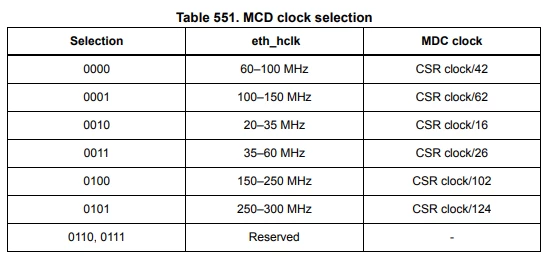

The code in HAL_ETH_SetMDIOClockRange() function for H7 series, starting from HCLK frequency of 150 MHz and higher, sets the MDIO clock divider to 102. Per IEEE 802.3 specification the MDIO clock must not exceed 2,5 MHz, which means that it will be valid for HCLK up to 2,5 MHz * 102 = 255 MHz. But for H72x/H73x parts the maximum AHB frequency is 275 MHz and for H7Ax/H7Bx parts 280 MHz. Obviously the solution is to add a range with a divider 124, which will be valid up to 2,5 MHz * 124 = 310 MHz. The code for H5 series is correct, although ironically the maximum HCLK speed for those MCUs is 250 MHz anyway. Also the comment on the line 2405 incorrectly mentions 200 MHz instead of 250 MHz.
In addition for HCLK frequencies below 20 MHz the code sets the divider to the highest value, which is the worst possible one. Instead it should set it to the appropriate or lowest possible value. For Fx series that means setting the divider to 16, but for Hx series the divider can be as low as 4. While very low HCLK frequencies are not appropriate for MAC operation, they are still valid for MDIO operation and PHY configuration, which could be useful for some projects.

Good find, thanks for posting. Immediately checked my code and found that I'm using the highest divider ETH_MACMDIOAR_CR_DIV124. :D
> Not only the first (hclk >= 20000000U) is damaging
Why's that "damaging"? With the divider of 16, MDIO clock is set to 1.25 MHz, that a problem?

Hi @Piranha ,
Thanks for spotting this point.
I confirm that the STM32H7 ETH driver shall be fixed for the MDIO clocks range. We missed the update in the latest version and it will be done in next release. (files enclosed).
"Not only the first (hclk >= 20000000U) is damaging, but all of the (hclk >= ...) conditions are just useless and increases the bloat"
Regarding the 20MHz frequency: it is not clear to me, because I think that frequencies below 20MHz should not be supported. But I need to check then get back with a confirmation.
But could you please explain why you think that all the other conditions are useless/bloat ?
Regarding the If/Else layout and coverage, the rationale is keeping the code easily readable and understandable and to align it with reference manual description. So it shall be generic (covering all derivatives of the same series) and simple to read.

Jul 13, 2023 3:17 PM UTC
Anyway, I've already read and acknowledged the other points, my question was simple: "Why you think that all the other conditions are useless/bloat ?". Your answer is that repeating the condition of the upper limit (ie. (x<5)->(x>=5)) is useless. Yes, that's true. But, as I already explained, it's simply a coding style allowing clear visibility of the code (table-like) and it doesn't add any useless bits of code since the compiler eventually transforms it into optimal sequence. Good for readers with no bad for footprint or functionality.
Sure, the comment line 2440 will be fixed
/* CSR Clock Range between 150-200 MHz */
should be
/* CSR Clock Range between 150-250 MHz */
Thanks for your contribution.
