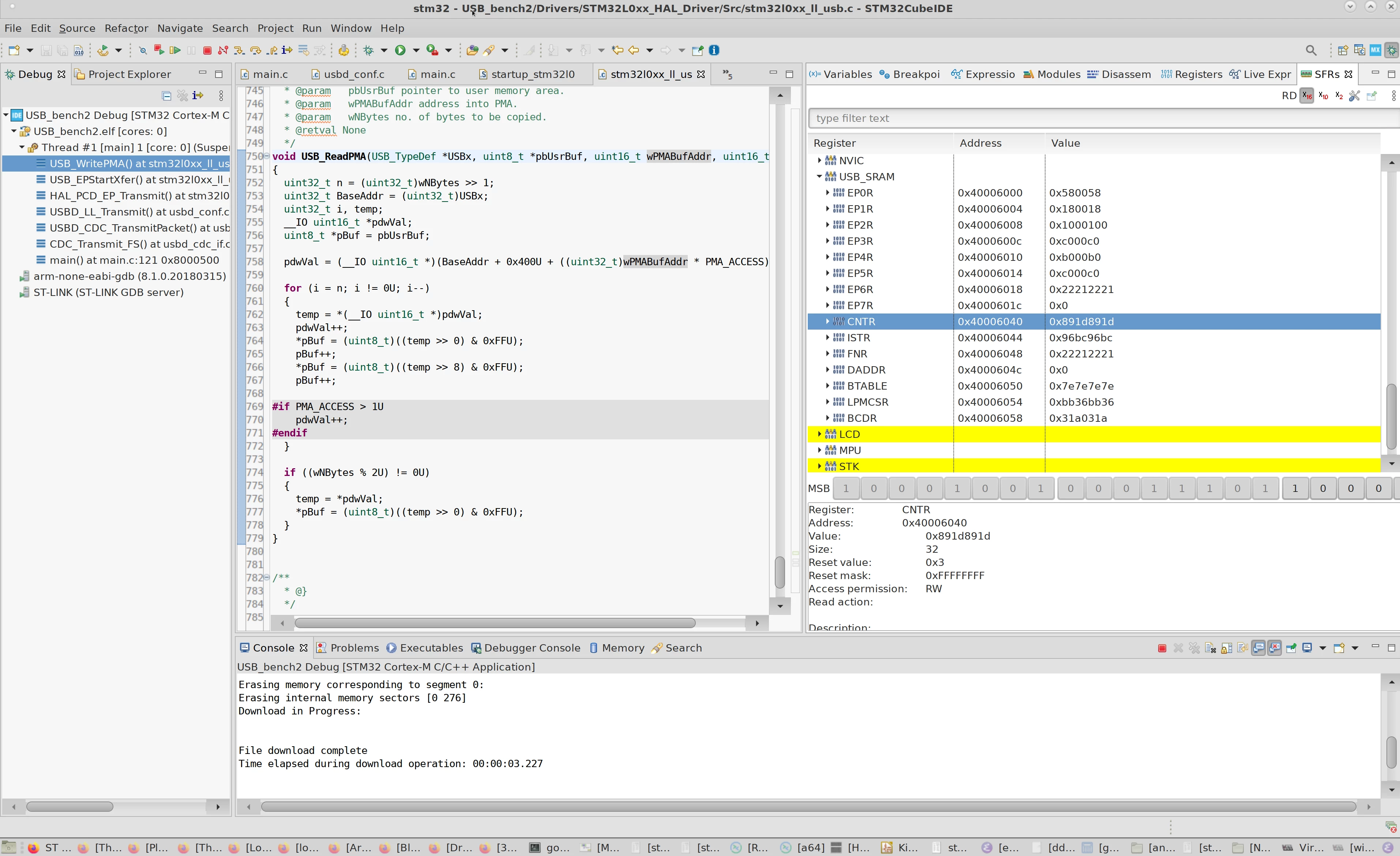

CubeIDE 1.5 Linux
create a new project with USB CDC
Start debug. Open SFRs window and scroll to USB_SRAM
USB registers at offsert 0x40 to 0x58 show up with obviously the wrong content.
The also correctly show up under USB_FS with the correct address and content.

Generally viewing peripheral registers in this manner is invasive and damaging to normal operation. There isn't a "magic window" and the debugger alters the peripherals internal state, this will break FIFO's in USB or SDMMC/SDIO type peripherals, and clear status bits in USART and ADC, etc.
Use very cautiously. If you need telemetry dump flow and content within your own code where you can limit the impact/side-effects.

thanks for the replies.
I am aware of potential side effects or reading certain registers.
What I was looking for was to examine the BDT and the buffer content itself.
Instead the register template is applied to the USB RAM.
